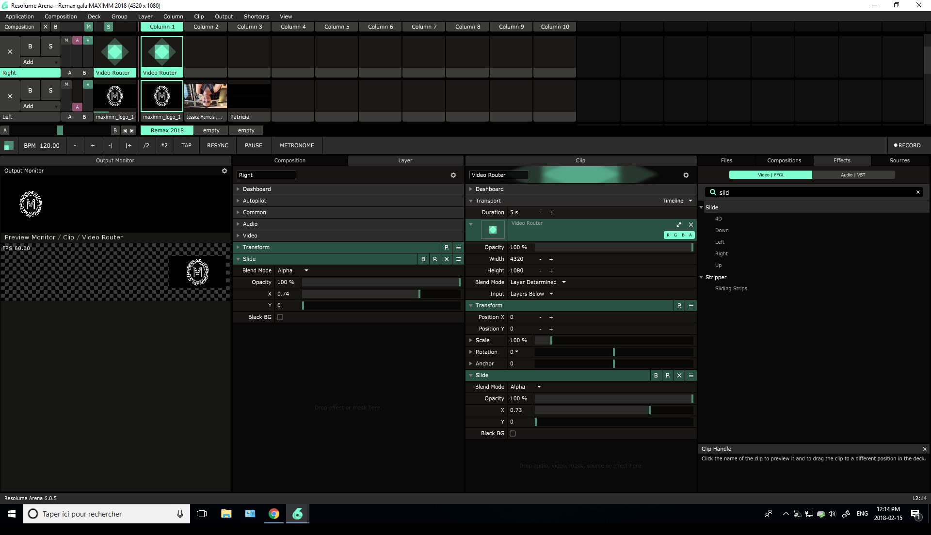

Sorry for the delay. Here's a screenshot where you should see all you need I think, if not just let me know.
hellslayer66
Posts: 5
Joined: Wed Jan 18, 2017 16:02
Re: Video Router Problem
Post by hellslayer66 »
I didn't notice I had all my screens in the screen shot.

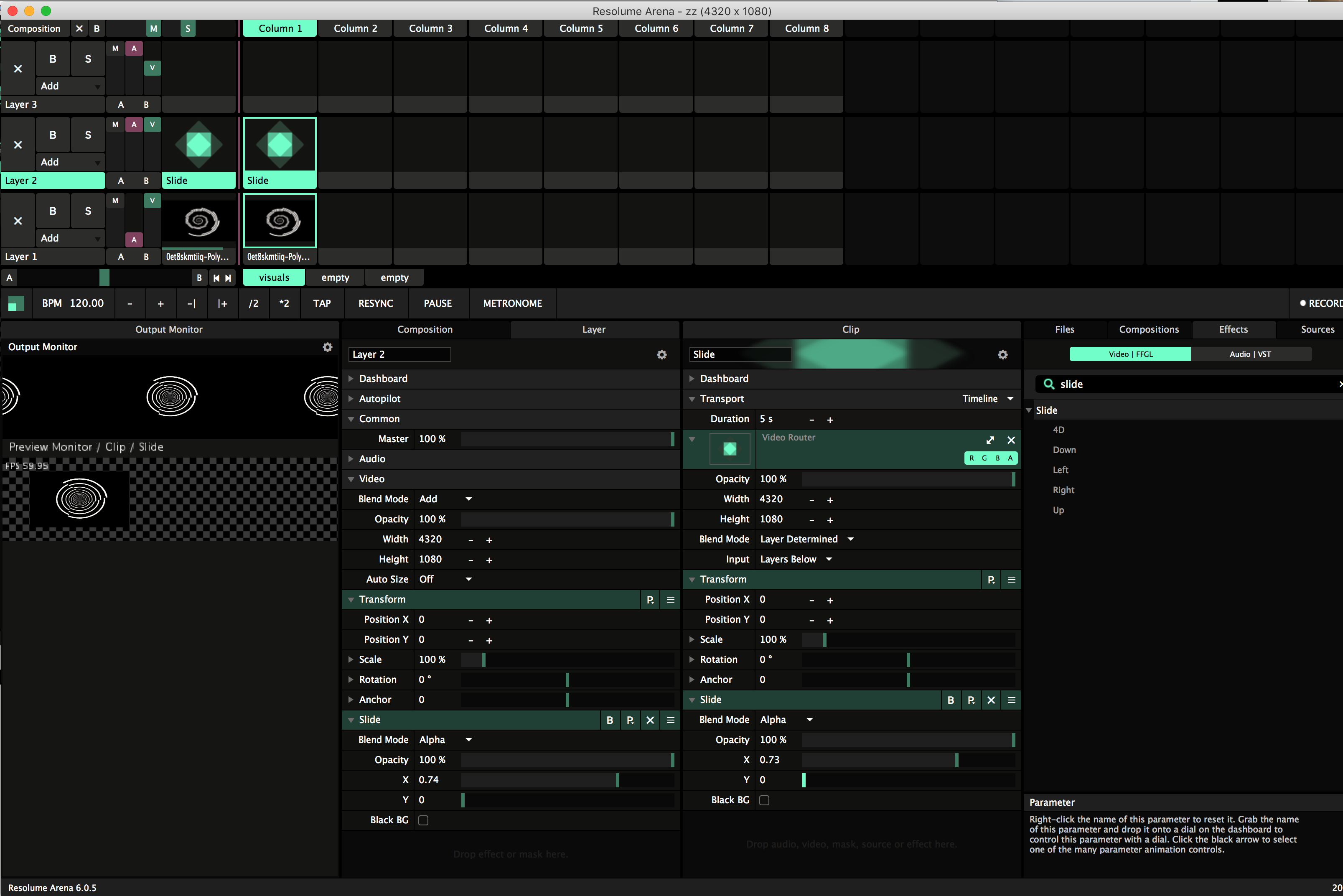

Posts: 7697
With the same settings as I see in your screen shot I get a different result, so I guess there is something else going on.
Could you attach your composition too?
