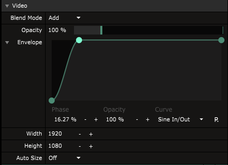

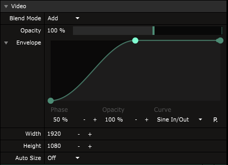

When using faders (midi) opacity slider visual feedback stops when an envelope hits 100%, that doesn't seem right?
Re: Layer Opacity, Midi, Envelopes, weird feedback.
Posted: Wed Jul 11, 2018 21:59
by Zoltán
That's how it should work.
The X axis of the envelope is the param control input/timeline, the Y axis is the output value / param value.
You can see the selected keyframe's opacity value is 100% in both screenshots.

You don't need midi to see the problem. Just add a point to layer opacity at X=50% Y=100%. When you move the opacity slider on the layer panel to 100% the one on the interface will only go to 50%.
Here is an example file with midi mappings on layer 1.
Posted: Thu Jul 12, 2018 11:08
by Zoltán
Thank you!
Looks like the layer fader is not updated when the param value doesn't change any more (at 100%)
When I move the middle keyframe from 100% to 99% then the fader updates all the way.
I'll create a ticket.
Turns out we already have a ticket for this #8792.

manoeuvretv wrote: Thu Jul 12, 2018 14:29 Thanks, will we be seeing a point release any time soon with a fix?
I can't give you an estimate on that.
As a workaround, try to set one of the 2 same value keyframes to a slightly different value, like from 100% to 99%.
