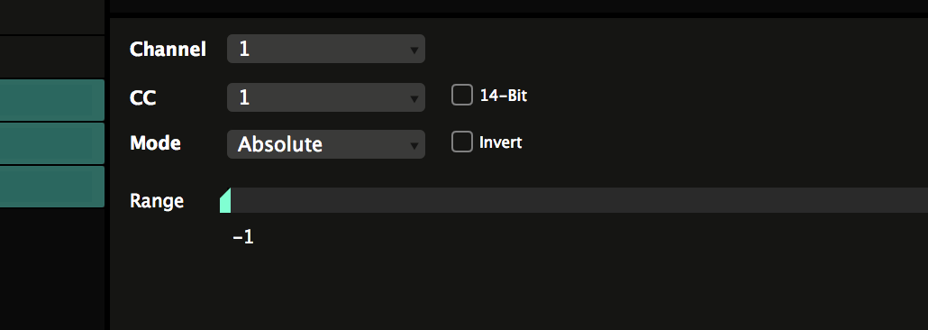

Zoltán wrote: Fri Mar 15, 2019 13:35
There is a 14 bit option for midi CC shortcuts.
Have you tried that?
Yes I have tried that, but i think this is not the feature I'm looking for. This is a pairing of two parameters with each other. For example on my Korg NanoKONTROL my sliders are being paired with a Button! When I select 14bit checkbox - my slider stops working at all.
Here's what I found about this feature in the forum:
The very rare 14-bit MIDI is the feature of the Continuous Controller MIDI specification, where any of the first 32 controls (MSB - CC 0-31) can be optionally paired with a control offset 32 higher (LSB - CC 32-63) and using them as coarse and fine parameters of a 14-bit value, and this way allow using 16,384 possible values instead of 127.
Although there are not so many hardware - synth, never heard about any MIDI controller that actually supporting it - or software that are actually supporting it.

If you have a controller that actually sends 14 bit MIDI, you can use it by enabling the 14 bit toggle, like Zoltan posted before.
If your controller does not actually send 14 bit MIDI, that button does not magically make your controller do so.
The combining of two CCs doesn't mean that you will be physically turning two knobs on your controller. On a 14 bit CC, your controller will read out the (stepless) value of the potentiometer of a single knob and quantize it to 14 bits. It will then send out the MSB on the first CC and the LSB on its paired second CC. By enabling the toggle in Resolume, Resolume will know to combine the value of that shortcut's CC with its pair CC, and calculate it back to a single value. That value is then used to set the parameter you assigned the shortcut to.
So on one side, you're turning one knob, and on the other side, you're seeing one value change. Aside from the higher range, there is no physical difference from a regular 7 bit CC.
Does that help explain it?
