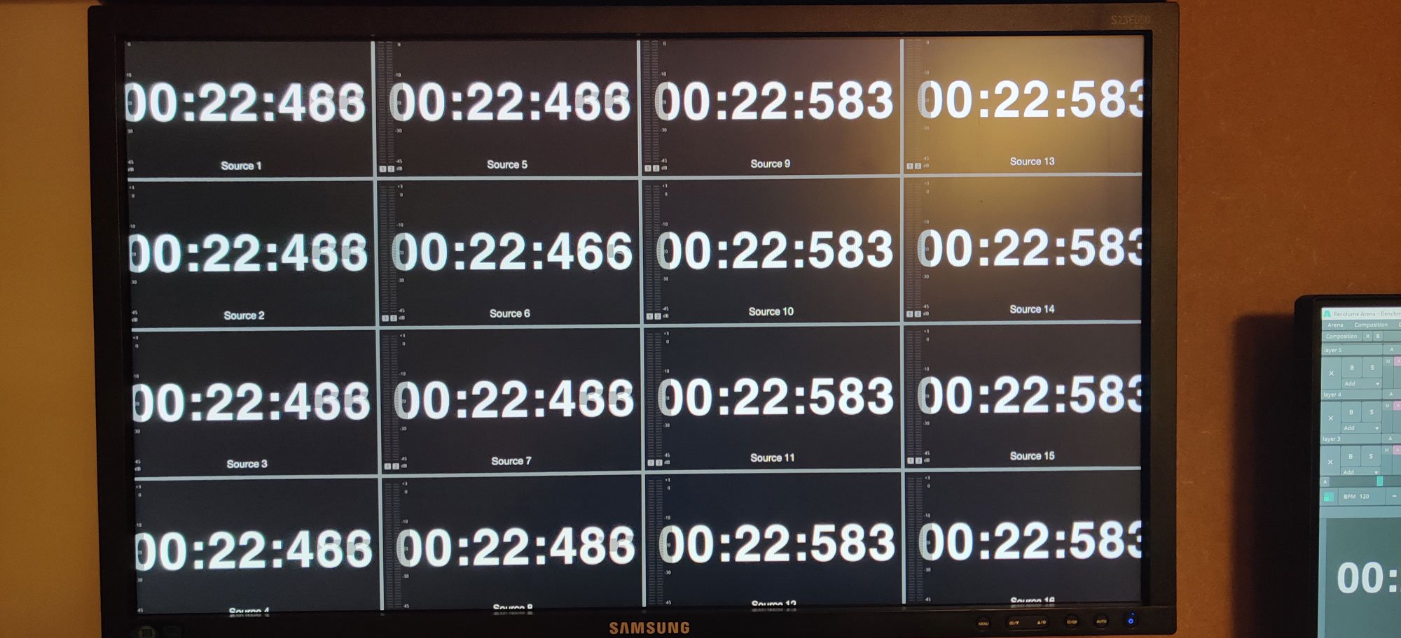

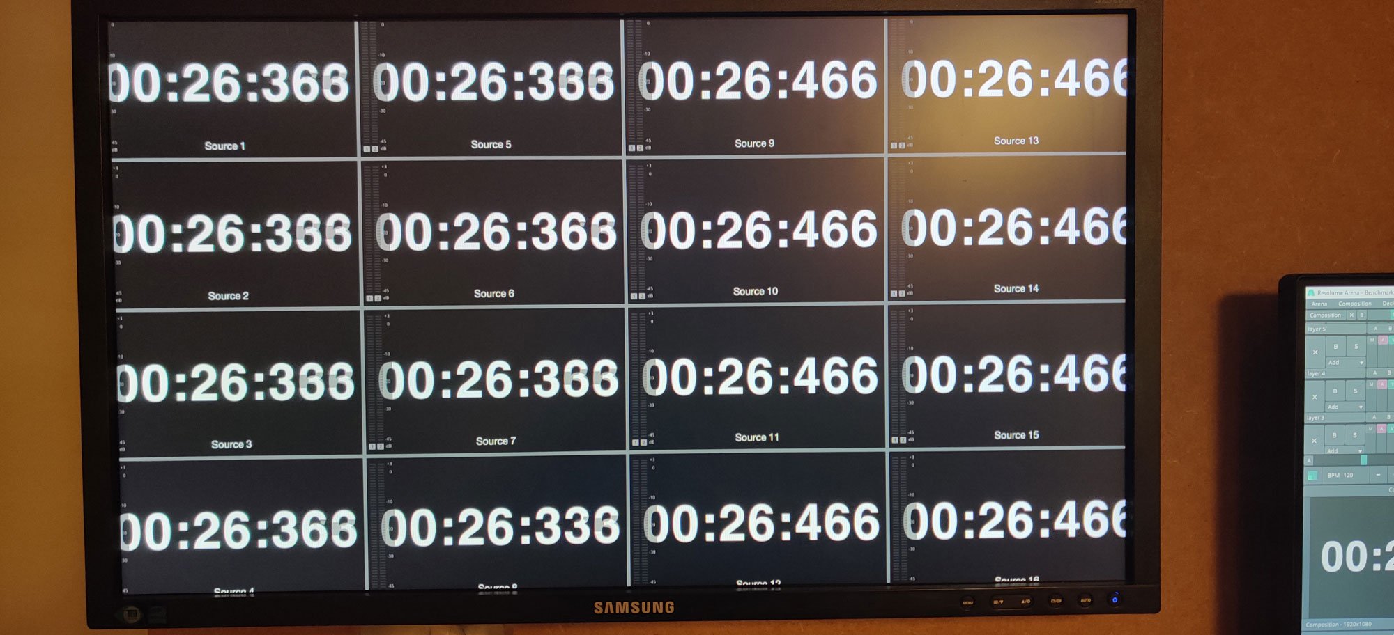

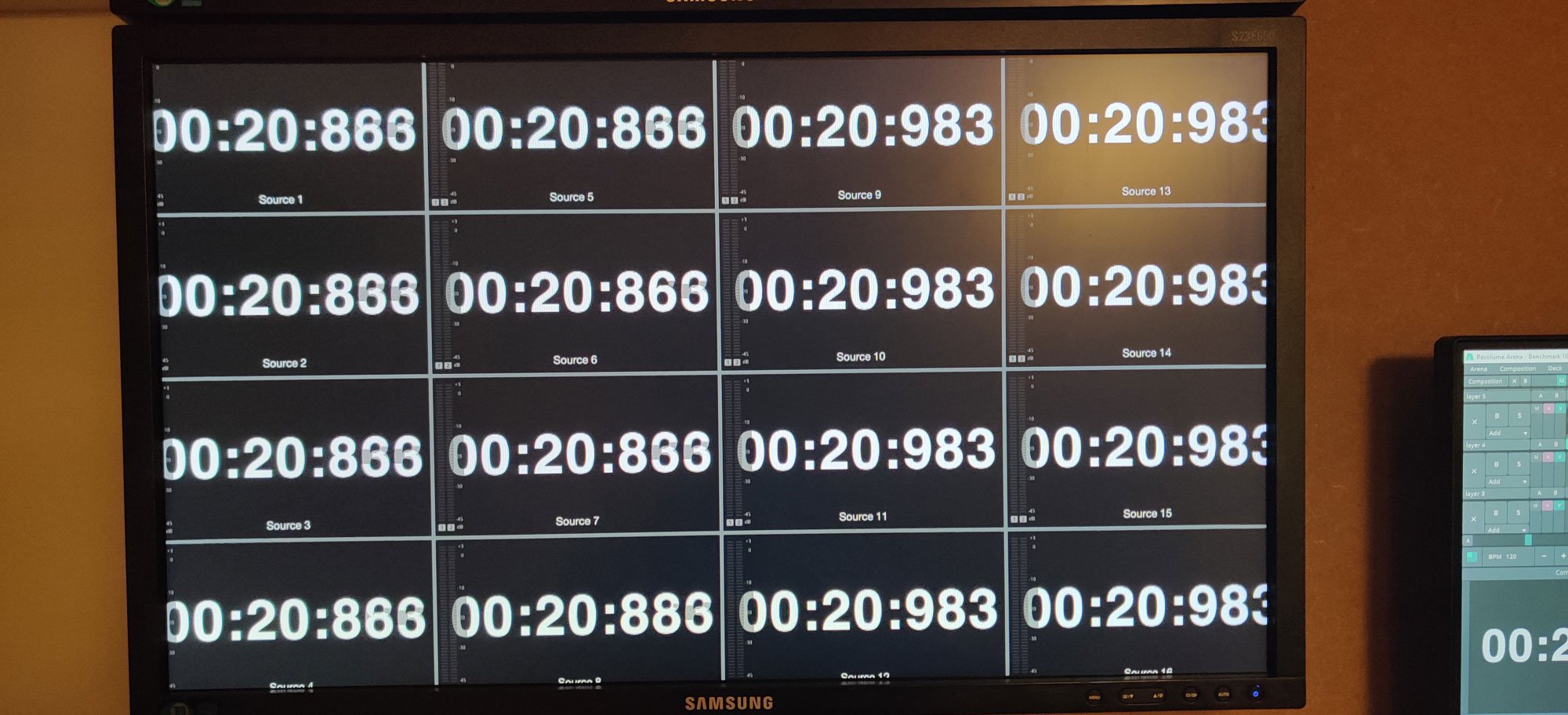

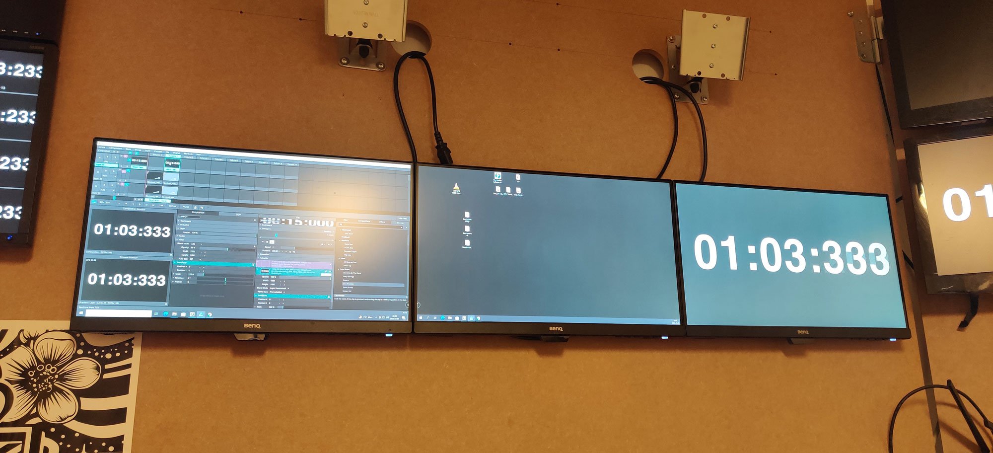

When I start up Resolume and launch a clip with MM.SS.MS counter, open advanced output and add both quad 2 card as outputs (any of the cards actual ports) and If I have all monitors in a cluster with the clip running, and then I use my phone to snap a photo of all monitors/outputs to see latency.
These are my findings!
GPU 1 (PCIE_1) shows 00.00.100 GUI + Discrete
GPU 2 (PCIE_3) shows 00.00.100 Discrete
SDI 1 (PCIE_5) shows 00.00.200 ±20ms On any output
SDI 2 (PCIE_6) shows 00.00.320 ±20ms On any output
Please see attached pics

Also, to discuss the decklink furthermore, I did try to output on all SDIs on both card, above numbers where generally consistent throughout and I ended up feeding 16x SDI 1920x1080 FHD into a BM Multiview 16 + 2 outputs active on GPU 1 beside the GUI on first and second screen.
So beside the 2 GUI monitors during this test I had 18 outputs active, a total of 37 324 800 pxls not counting GUI monitors.
To simplify that would total to a resolution of 8640x4320 pxls
FHD 1080p benchmark came in around 51 layers (noise) before hitting the 30fps limit.
I can also mention that each cards 8 outputs where “almost” in sync. Please see attached pics of counter for reference.
1 card is basically 2 cards on 1 pcb. The cards internal routing is designed as a dual system to simplify fill and key according to the peeps at BM, could be so but this really fucks things up if you ask me!
