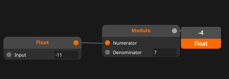

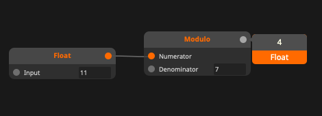

It looks like the Wire node 'Modulo' gives incorrect values for negative numerator inputs.
Example according to Wolfram Alpha:
11 mod 7 = 4
-11 mod 7 = 3
In Wire:
11 mod 7 = 4 (correct)
-11 mod 7 = -4 (incorrect)

Re: Wire Modulo Node giving incorrect value for negative inputs
Posted: Wed Feb 15, 2023 18:06
by Zoltán
There are some ways to do mod, looks like wolfram does a different one than Wire.
If you try the same in Processing you get the same result as in Wire.
