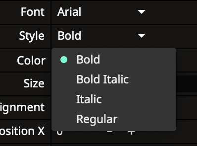

Which fonts?
- Attachments
- Képernyőfotó 2023-03-02 - 14.02.54.png (29.54 KiB) Viewed 7856 times

Haha, I should have said Arial is one of the few that does.
Please have a look through the list and compare with Fontbook as I did. It's a majority that do not have styles available in Resolume. It's the same in Mojave too. Windows 10 has all the options for all the fonts.

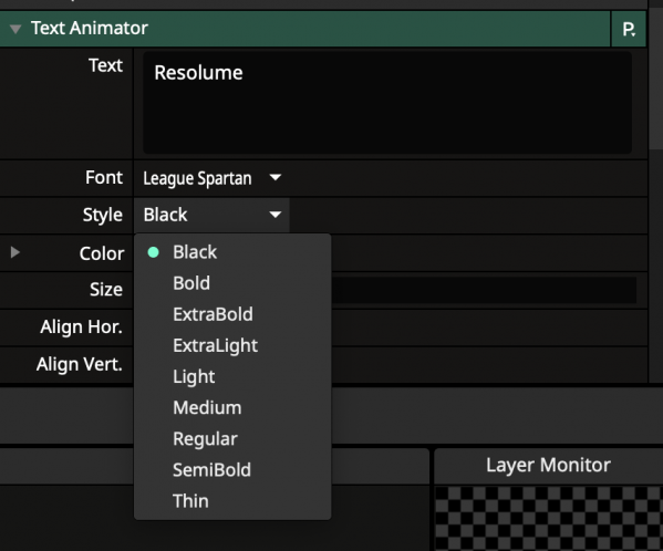

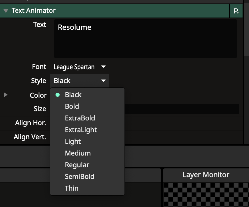

If you install 'LeagueSpartan-VariableFont_wght.ttf,' it's true that only 'Thin' will be displayed, but isn't that simply because Resolume does not support Variable Fonts? If you install the 9 independent TrueType fonts found in the 'static' folder, 'LeagueSpartan-VariableFont_wght.ttf' will be removed, and they will all be displayed as shown in the attached image.

Variable fonts are not supported yet.

Thanks! It seems like the problem was that we installed everything, variable AND fixed. Once we uninstalled the variable, Resolume was able to see the fixed, whereas it was unable when variable was installed. Silly mistake on our part.
