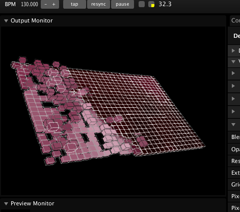

Can you post a screenshot? This is what it should look like:
Picture 1.png (115.65 KiB) Viewed 9537 times

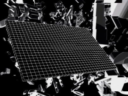

Looks like this (even with alpha as mixmode, which i finally found after looking through that list a hundred times ;) ):
ScreenShot 1.png (155.73 KiB) Viewed 9509 times
