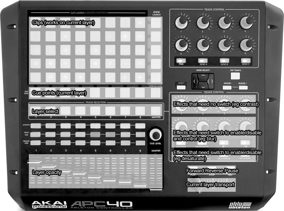

Alfaleader "Also watch out, because resolume can't use the row with the play/stop/record/... buttons." Did you mean resolume won't allow you to MIDI command those functions or that the APC won't allow them to be programmed? I found a couple of different setup's for that bank of button's and a few that use the functions, but i would greatly appreciate any advice, tips or tricks either of you could give me!!! =)
Olivepixel was running the bank for layer selection and using the functions (well.. just forward reverse and pause) above the crossfader --> download/file.php?id=723
Cozer has his forward, reverse, pause, and random in the clip launch bank and has his set up "stock" I believe so he can have 8 banks with 8 knobs + master for 72 knobs total --> http://vjcozer.com/images/midimaps2.png
But I still have not found anyone controlling the loop, bounce or other playback modes yet... I assume this is because those are layer specific commands and not for the whole composition??? Or am I looking at this all wrong and those (being forward, reverse, pause, and random) commands are only available in these setups because they use a "layer selection" to apply them thru as opposed to trying to have a main composition control??? <--- Epiphany lol ;)

I couldn't get the "track selection/navigation" part to work directly in resolume.
For the playback modes for each layer, you could do "view->show layer transport modes". You can map these things to midi.
