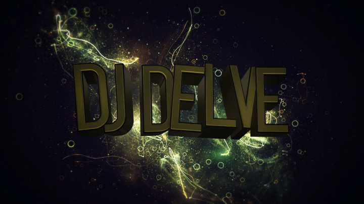

Weird because both After Effects and Photoshop show that I have a true alpha channel on my video clip. Iʻve attached an image as proof – itʻs showing all white on the parts that are visible.

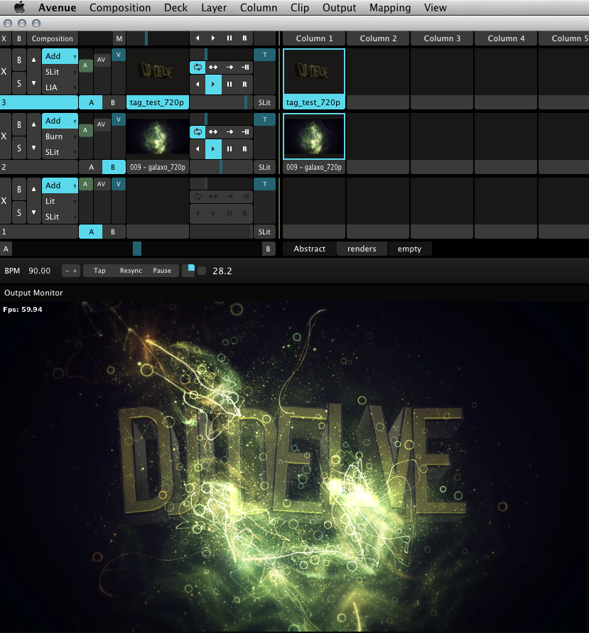

Attached are two images, one with how the alpha channel looks in After Effects, and an example of the same setup used in Resolume. As you can see, the layer blending mode is on Add, placed on the topmost layer and it still shows transparency through the layer below.
AFTER EFFECTS

RESOLUME
Screen Shot 2012-09-07 at 11.28.06 AM.png (670.37 KiB) Viewed 17610 times
Re: Way to disable layer blending?
Posted: Fri Sep 07, 2012 22:33
by cvanhoose
Grouping, you are on both A and B.
Posted: Fri Sep 07, 2012 22:53
by hyp
cvanhoose wrote:Grouping, you are on both A and B.
Man, you just saved the day with that single line. Thank you good sir!
