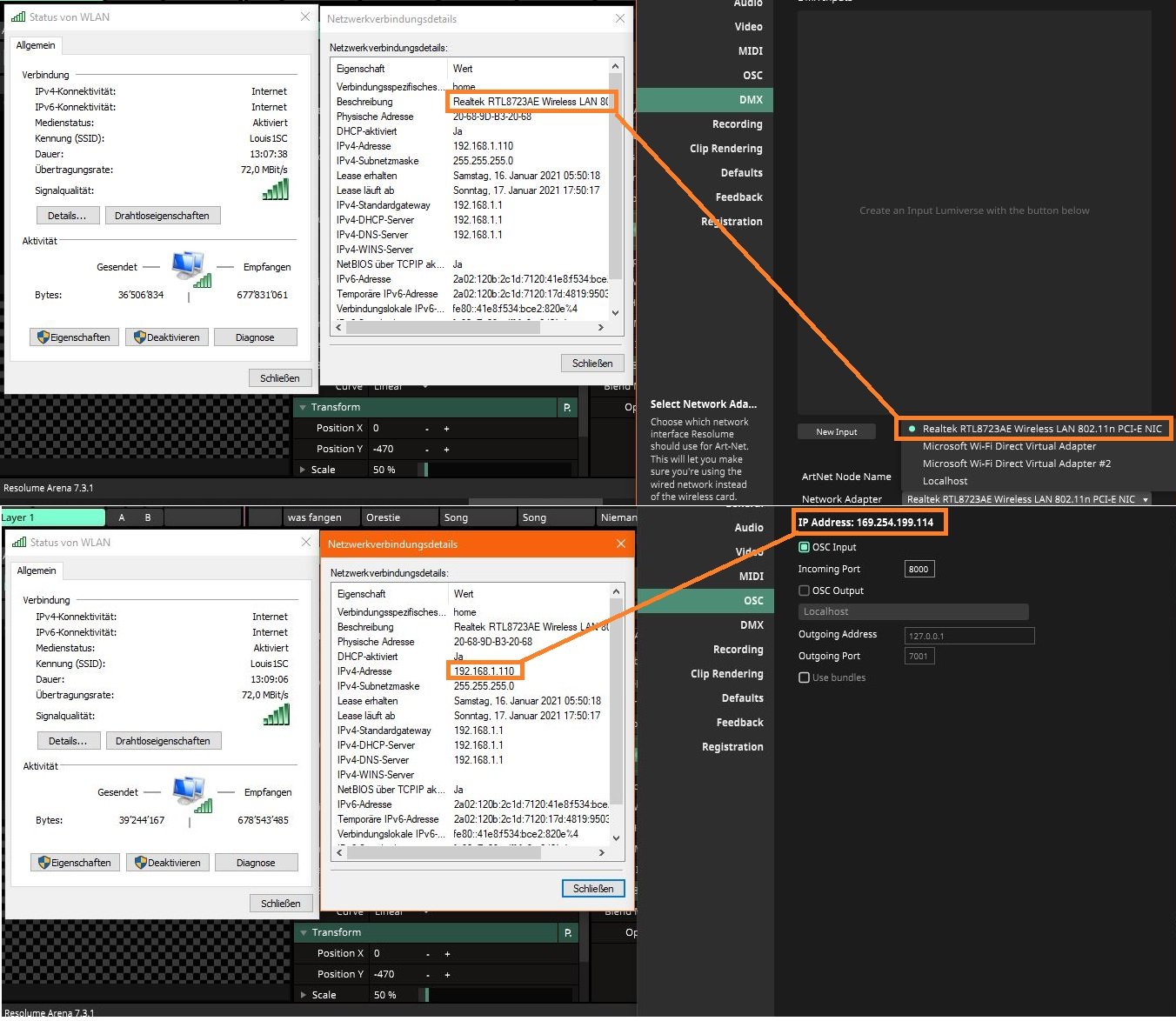

Why i can`t give an IP Adress?
Resolume grabs permanent WRONG ip Adress.
Thats rubs my nervs!!!
ALL other Software can handle an IP Adress given by User.
In my complet Network i nowhere have a 169.XXX.XXX.XXX IP.
My IP is now 192.168.0.110
But Resolume think i have a Bluetooth Adapter or some like this for OSC.
And,... i can`t change it.
Newstart of Resolume give no effect, newstart for PC give no effect.....
That i can`t change the IP for the Software -NO i NOT wanne change the IP of my Computer!!!!- is *******
A normal PopUp Window where i can give a custom IP -like ALL other professionell Software can do- will solve this ******
Is there any Update in Line that change this bug???
IP adress rubs my nervs

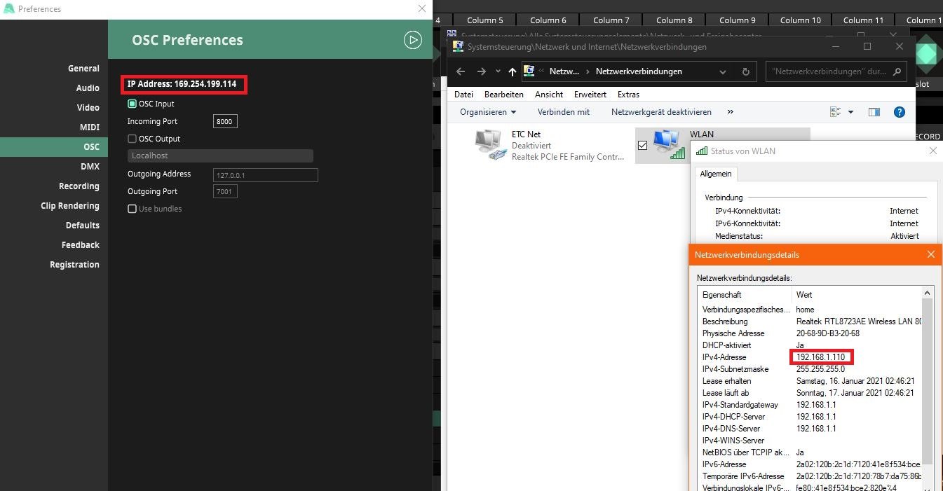

Re: IP adress rubs my nervs
This is just information of your first found adapter.
Is OSC input/output not working?
The Adapter is wrong.
I work with Cable-LAN for my connection Resolume-Lightdesk.
WLan for Internet.
And Resolume ever choose a Non-Existadapter (i know 169.254.XXX.XXX is when Win10 find an IP Adress it is in use and "create" a "virtual" Second IP for this Adapter) for try connect.
Apple is more worse...
All i wanne do is, say free what IP Resolume have to work with.

(For first question, with this i work in IP Range 10.101.XXX.XXX and 255.255.0.0 for sACN for my Lightsystem. I not wanne change my System because one User in my system can`t handle IP Adresses. I want that this User can work with an User-Given-IP.)
WLan for Internet.
Yes, sometimes OSC not works
What NIC adapter is selected in your DMX preferences tab?
Thats my settings...
My Nick is the result of being angry with my Laptop,...... not with Resolume
Resolume passes the OSC packet to the system and the system sends them based on the Routing table.
As I said, the interface IP you see there is just info, Resolume listens on all interfaces.
The DMX adapter setting is only for DMX input and output.
Triggering an empty clip slot also works if you have "Own layer" set as composition clip target.
