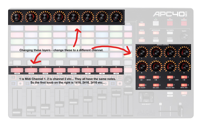

The problem with the APC is that each layer has sends separate channels for most of the knobs. I've attached a picture.
I guess a feature request would to be either to set multiple midi commands to a single parameter or allow for merging of channels so all notes from any channel act the same.
I think for now I'll have to loose a channel (probably 8) and make that the global midi channel so that if I switch to that on the controller its signed to composition control.
This is what the APC does for the buttons on the right in Generic Mode ( not for the buttons on top though, afaik ). Res 4.2 will let you set the Mk2 to Alternate Ableton Live Mode, so it functions as expected. For now you should be able to set it in the right 'mood' in Ableton, and it should keep this setting in Resolume.
Re: Need help with mapping APC 40 MK2
Or use this: http://www.tunecrew.com/2013/07/10/apc4 ... kai-apc40/
The sysex messages are the same for the Mk2.

Thanks. Opening Ableton did indeed change the controllers setup, quite a weird workaround. The APC does't show dial lights now nor current layer but at least the dials are consistently the same note.
I did give the Java app a go but its pretty old and only spat out errors when running.
Yeah. It's even more annoying that apparently the Mk2 sets itself back to Generic every time you power cycle it. Which is basically every time you use it. Not sure why Akai chose that mode to be the default, because as you found out, it acts pretty non-generic...
It's just a matter of sending the correct Midi Sysex when it's connected. We didn't have a Mk2 yet when 4.1.11 came out, but we've fixed it in the upcoming Res 4.2.
