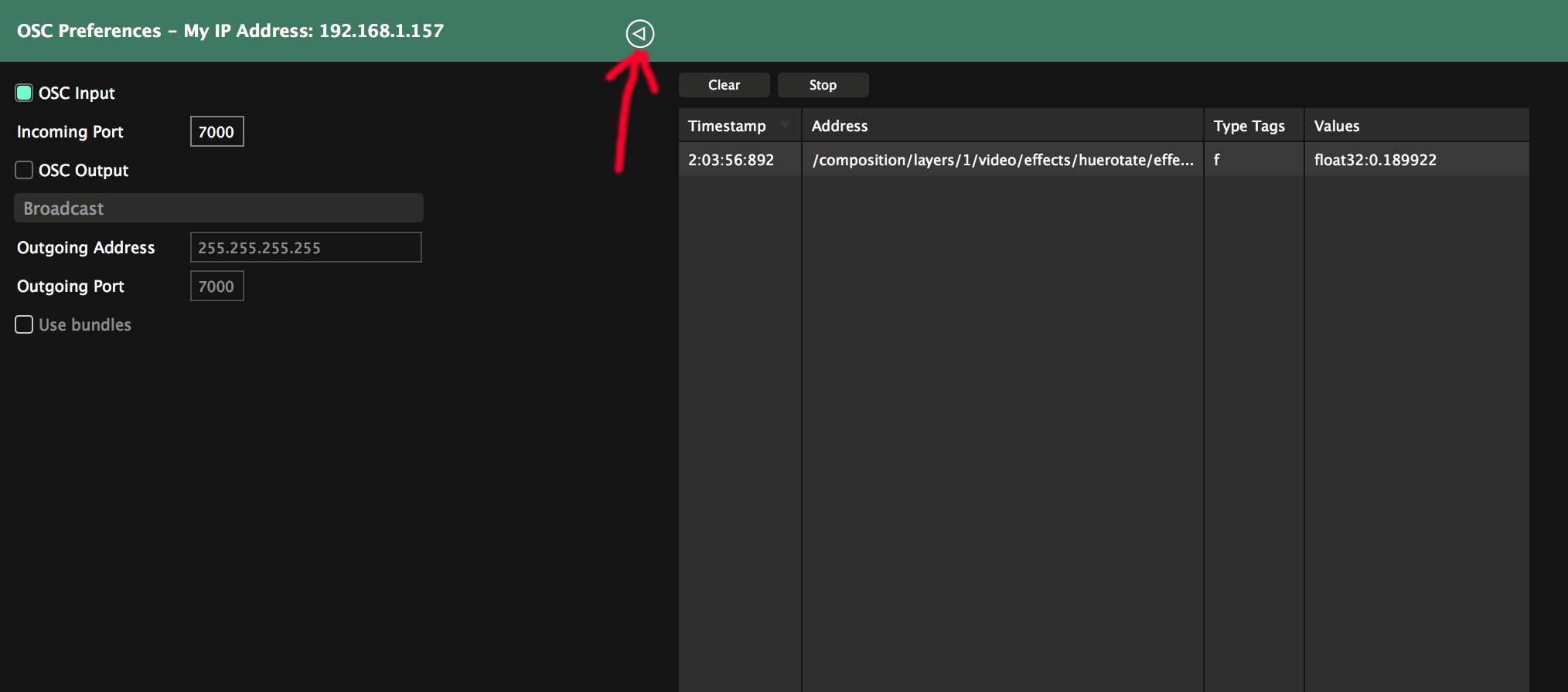

Posts: 7704
Re: hue rotate not working on TouchOSC
reteet wrote:Could someone else test if they can control hue rotate and bright.contrast effect through touch osc?
Yes it works fine for me.
Could you post a screenshot of the OSC inspector what you are actually getting into Resolume?
You can open it with the button shown with the arrow

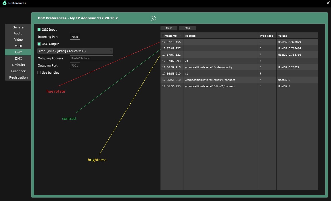

reteet
Posts: 16
Joined: Tue Nov 28, 2017 18:12
Post by reteet »
In the picture you can see me triggering a clip, then changing page in touch osc and change layer opacity, then change page in touchosc and try to change value of brightness, contrast, hue rotate
edit to clarify: Using these addresses in touch osc editor
for brightness: /composition/layers/1/video/effects/brightnesscontrast/effect/brightness
for contrast: /composition/layers/1/video/effects/brightnesscontrast/effect/contrast
for hue rotate: /composition/layers/1/video/effects/huerotate/effect/huerotate
with floats from 0.0 to 1.0
