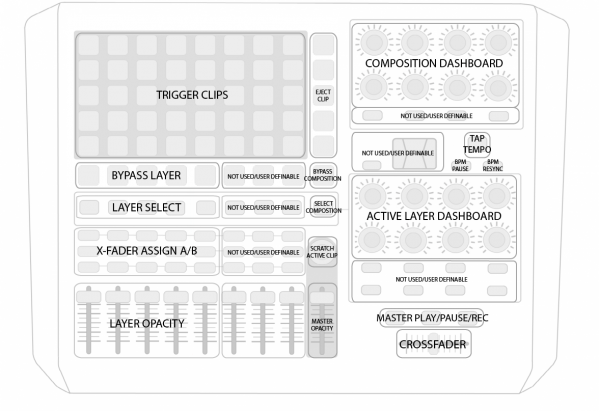

Re: Akai APC40 - Anyone have a Midi Map?
Here is a simple template for the APC40 to get you started. It's a simple battle/crossfader layout, with support for 5 layers and room for customization.
- Attachments
- APC40Template.zip
- (293.18 KiB) Downloaded 4242 times
Goto10. Thanks for your apc40 template. Do you have a suggestion for how to set up a page forward and back function for the 'trigger clips' buttons on the controller to trigger columns beyond 1-8 (9-16, 17-24, etc.)?
Resolume does not support a 'clip trigger grid' like this.
If you want to access more than the first 8 assigned columns, you will have to resort to Bomes wizardry.
BTW, generally this limitation forces you to keep deck size down to around 40 clips per deck, which greatly improves stability and deck switching speeds.
