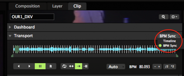

Have you checked your Timeline transport mode set to make sure it's not set to BPM instead of Timeline?
If so, change it to Timeline and you should be back to normal.

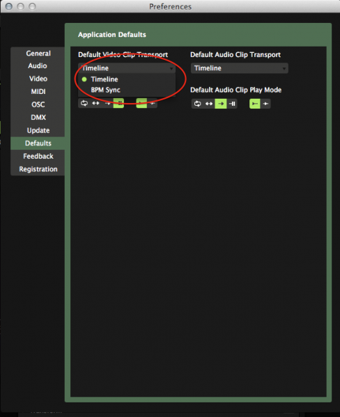

Also, you might want to check your preferences to make sure the BPM is not the preferred mode if you'd rather have Timeline as the default mode when you import a video clip

Post by bdeschryver » Wed Jul 02, 2014 10:38
unfortunately for me, it is set to timeline...
