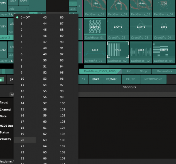

Cannot add color on Midi Mapping, i'm missing something? APC MK2

> Yes i have, when i select APC 40 MKII on presets the controller lights go up, but I can't change any color.dinga wrote:You have APC40MKII selected for input and output in the preferences options?
1. Already existing mapping show the table color, but when i try to change, controller button light goes off
2. New Notes appear the table in the image above
Also when i close and open again, Resolume doesn't set the right mode on Preferences Menu, nor Shortcut Midi (always default).
Windows 10 User btw
