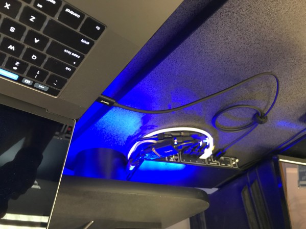

Good news today, I received my type C to DisplayPort cable. 15 bucks us. 4K@60 no problem with DisplayPort. No latency at all.
Here is a test with a single type c to DisplayPort cable ------>data path. The computer runs like a champ with tons of effects.
Its been a long battle with these things but, I am happy with them again. I use them to edit and the weight and size of them makes them a keeper.
