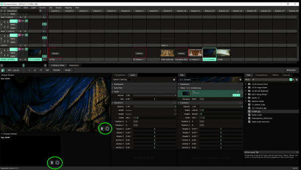

Re: Low FPS (gtx 1070 maxQ)
Take a look at this picture. Are you getting the same logos as what I circled?
Post by Kadete »
Oaktown wrote:Take a look at this picture. Are you getting the same logos as what I circled?80D1C66B-542E-448C-B24B-C310D4448D7D.png
https://resolume.com/support/en/shadowplay
Post by drazkers »
That's a rough weekend workin Vegas. Tearing, low fps and shadow play enabled. So I've found if you use adaptive you get the best of both worlds.
