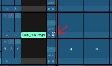

Posts: 1626
Re: Clips navigation with midi or keyboard
Also want to drop some words here... ;)
Having the ability while setting up a show composition in the office without any midi or osc peripherals connected to Resolume.. fast stepping through hundreds of clips for quick checking their state (alignment, speed, colour,..ect) the possibility doing this with the arrow keys was PERFECT!... Now the only way doing that on the fly is via mouse...it now takes almost twice as long.
Sure...I can script myself something....but that's not very convenient from my point of view.
So my wish:
Implement the old default keybindings with the option to remap or delete them. That would be wonderful :oops:
Best wishes
Posts: 1626
ok ok :) I get it....I'm an idiot :P
I just have to map this....
Sorry guys! :)
