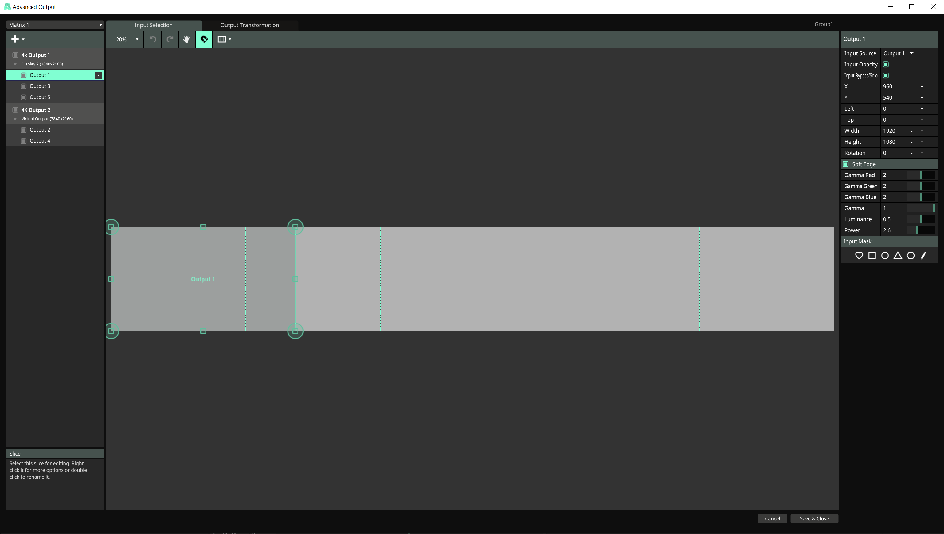

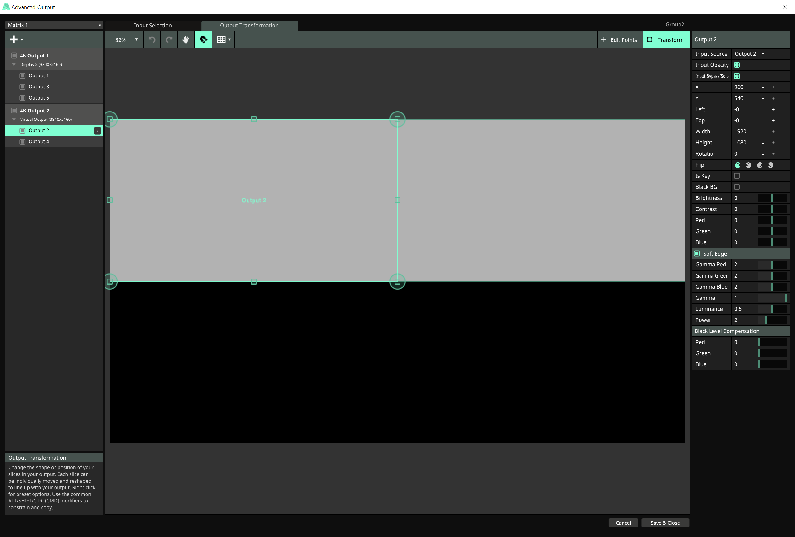

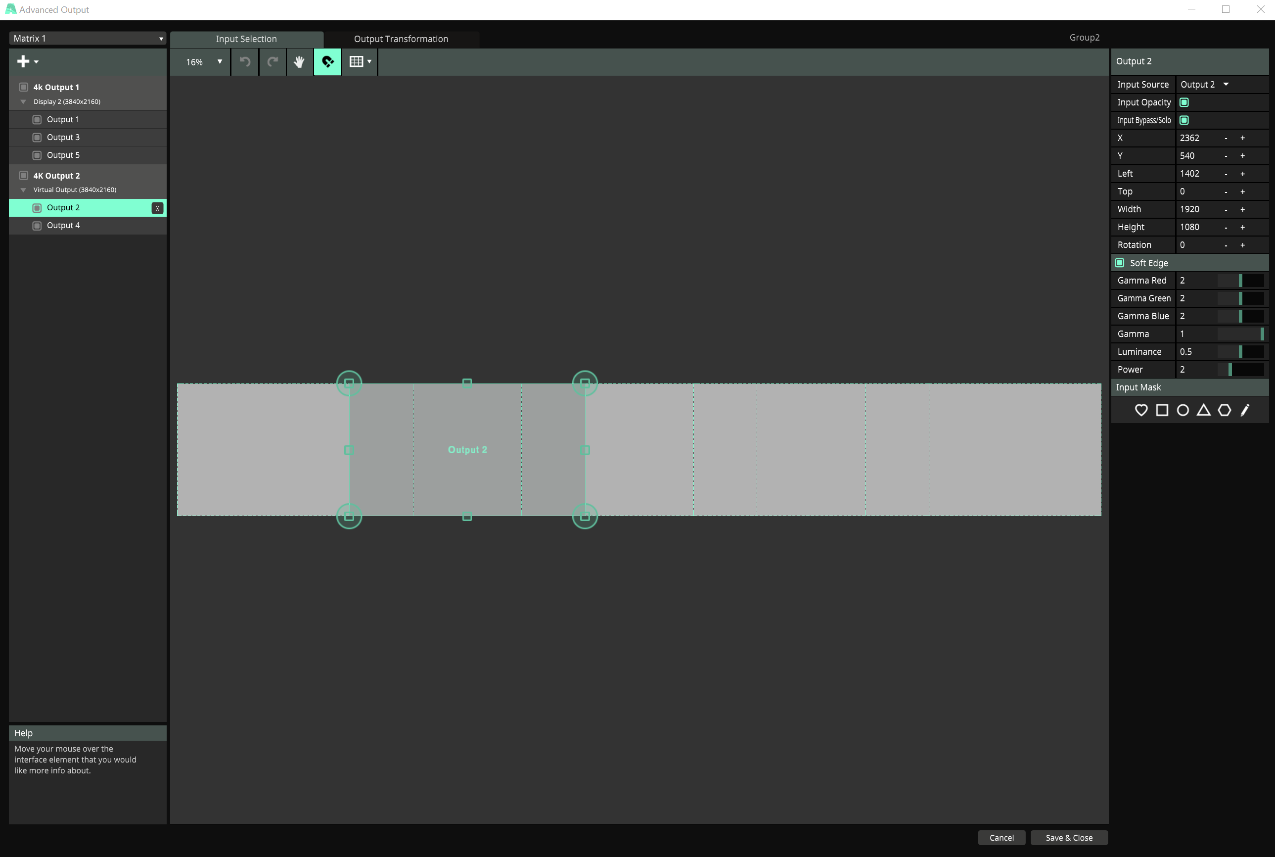

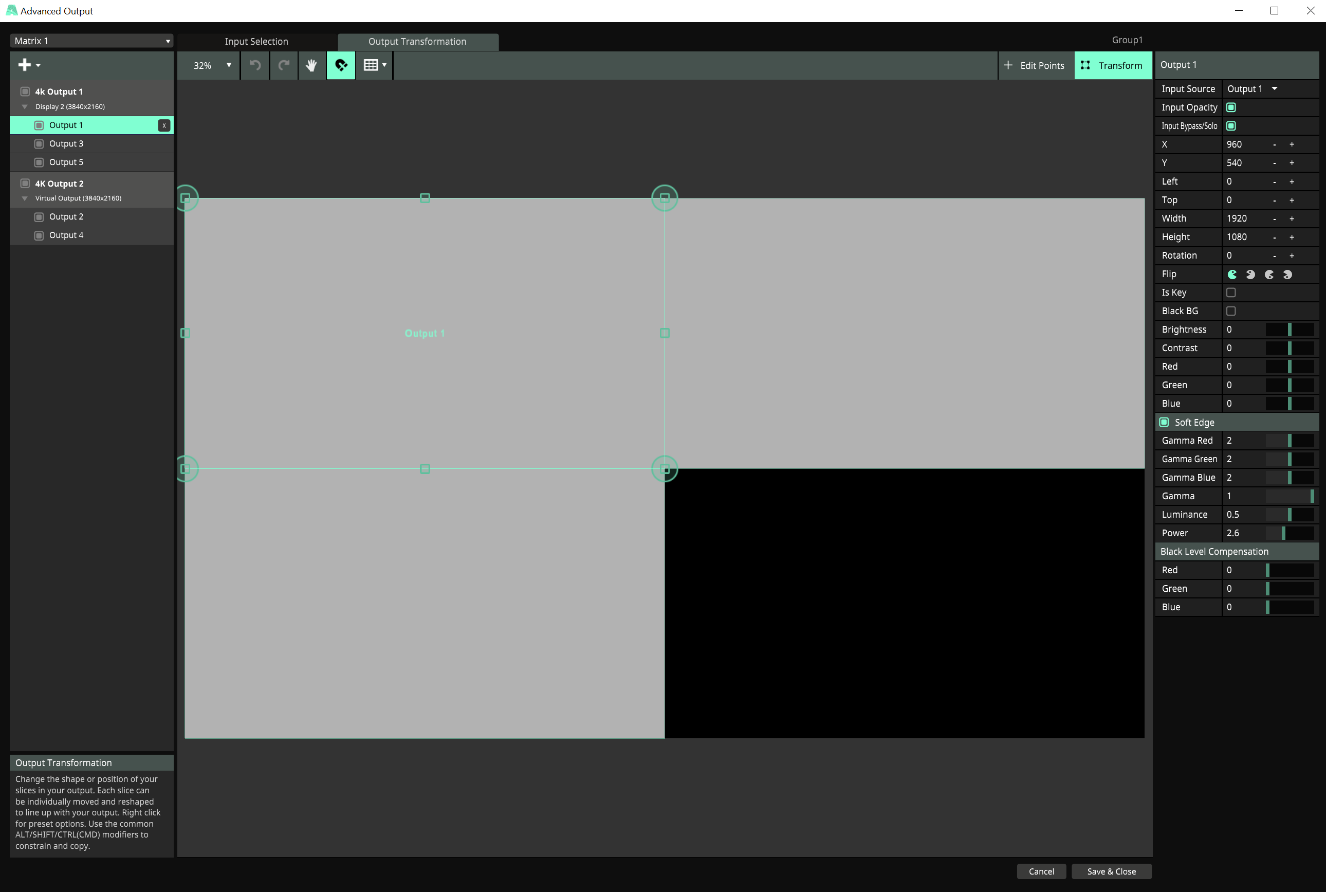

Im doing a double quad split to 2 4K outputs of a composition thats 7526X1080. 5 projector blend at 27%.
Im not seeing the soft edges. Does it not work when you do a quad split?

Posts: 7705
Re: Soft edges not activating
Try setting the slice input to the same source.

Hi Zoltan,
It is the same source, its a 7526X1080 clip.
Intange
Posts: 57
Joined: Thu Oct 31, 2019 17:25
Post by Intange »
Ok I get it, I have to use the same slice source. Thank you, that works now. Awesome. I love Resolume.
