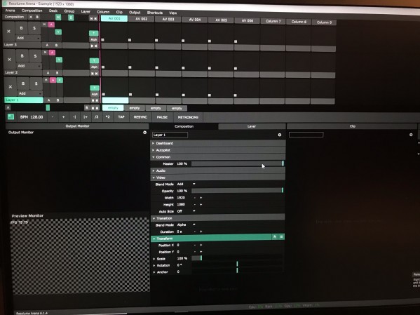

Hello,
I've been using Resolume 6.1.3 on a relatively new 2019 Razor Blade 17" laptop for about two months now. But for some reason today, the program decided to not completely start. The interface comes up but that's about it. No clips load and I can't open another composition. There is small white square in the corner where content has been assigned. The location of the content on the hard drive has not change. I even have to use FORCE QUIT to close the program. I've included a photo below.
I've downloaded a new copy of the software and reinstalled it, but received the same results as above.
How do I fix this?
Posts: 7535
Re: Resolume 6.1.3 Not Completely Starting...
Select a working audio device in the Resolume Audio preferences ;)
