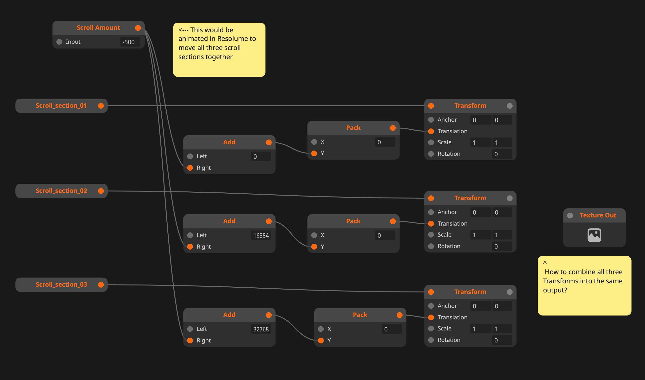

I'm trying play a credits-style scroll through a very long list of names. My PNG exceeds the 16384px limit, so I'm not able to import it into Resolume.
My thought was to splice it into multiple files, each 16384px tall, and to build a patch in Wire that could take several of these (let's say five max), offset them all in space so they're right above each other, and then scroll all of them at the same speed.
I'm running into an issue combining these textures -- is there really just a maximum of two textures as you said above? Can you think of any other workaround, or perhaps I'm missing something obvious?
A screenshot of my WIP (first Wire project!) is attached.

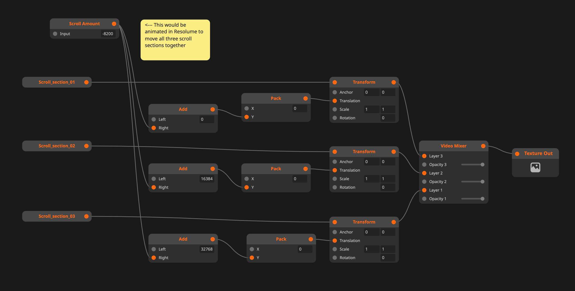

Following up,
It turns out the Video Mixer has the ability to pick more than two inputs. It was a simple matter of setting it to three inputs and now my proof of concept appears to be working :)
