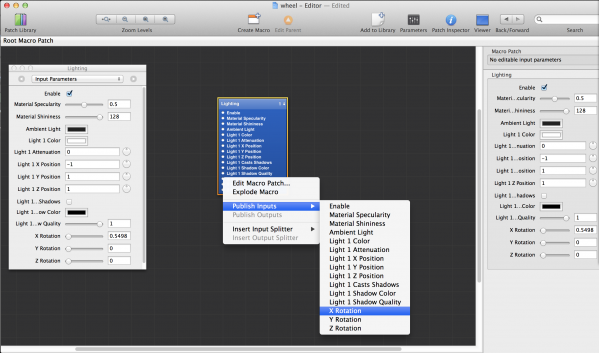

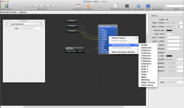

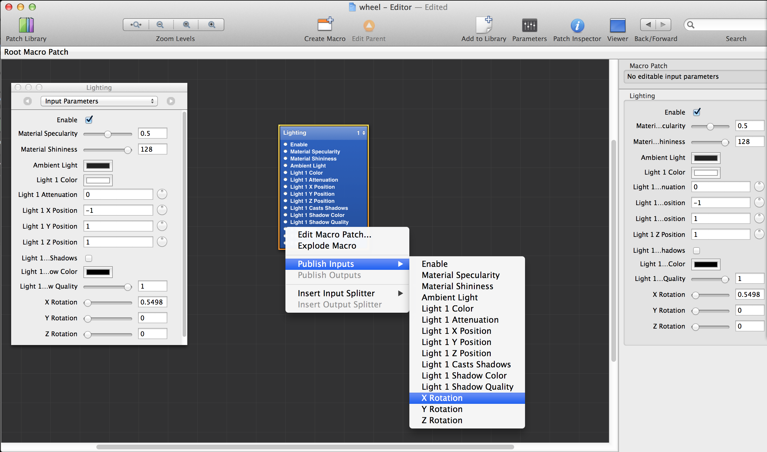

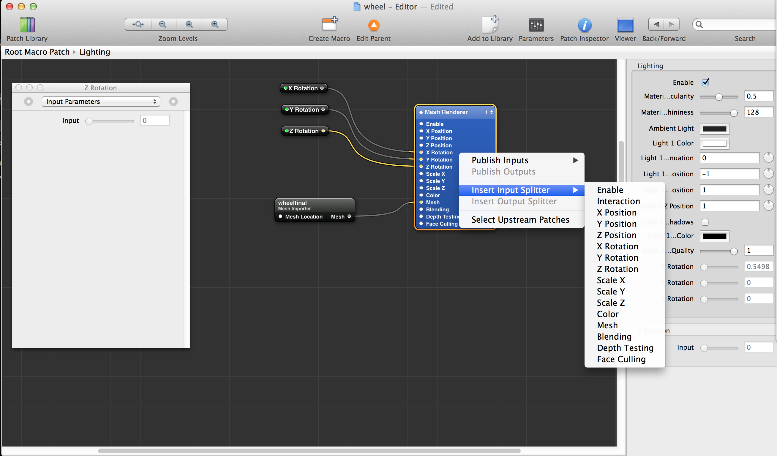

ahh ok... there are tutorials for quartz composer if you are fresh, but here is a quick model I made and a couple of screenshots along with a video to show you how I did it.
You will need to add an input splitter and change its type to NUMBER and set a max value of 360, This will give you a full 360 rotation, do this to all parameters you would like to publish.

Since my Quartz composition is in a lighting effect, you need to go to the Parent directory and publish the inputs you want Resolume to see.

Once in Resolume, you will see the parameters and can then link to BPM, Audio input, etc. or just control them manually with midi;)
