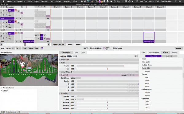

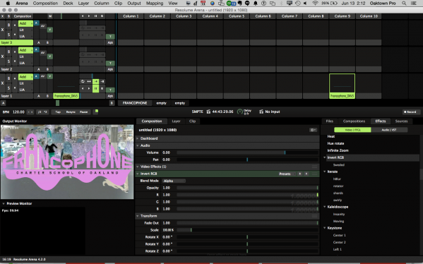

Good point but let's say you only use the "Invert Colors" option, all you have to do is use the "Invert RGB" video effect on your composition and you're set.
Invert your screen colors and take a look at this png:
Or here is what it looks like when colors are inverted:
