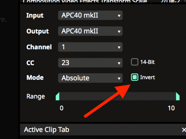

Doesn't this do what you'd like?

Unfortunately the option isn't there for me since I'm using the CC as a button. Could you add the Invert option to Button Mode (Non Piano Button Mode)?
