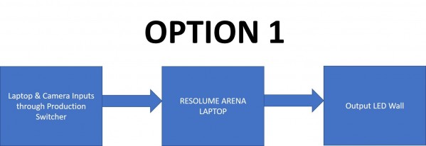

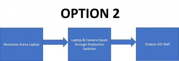

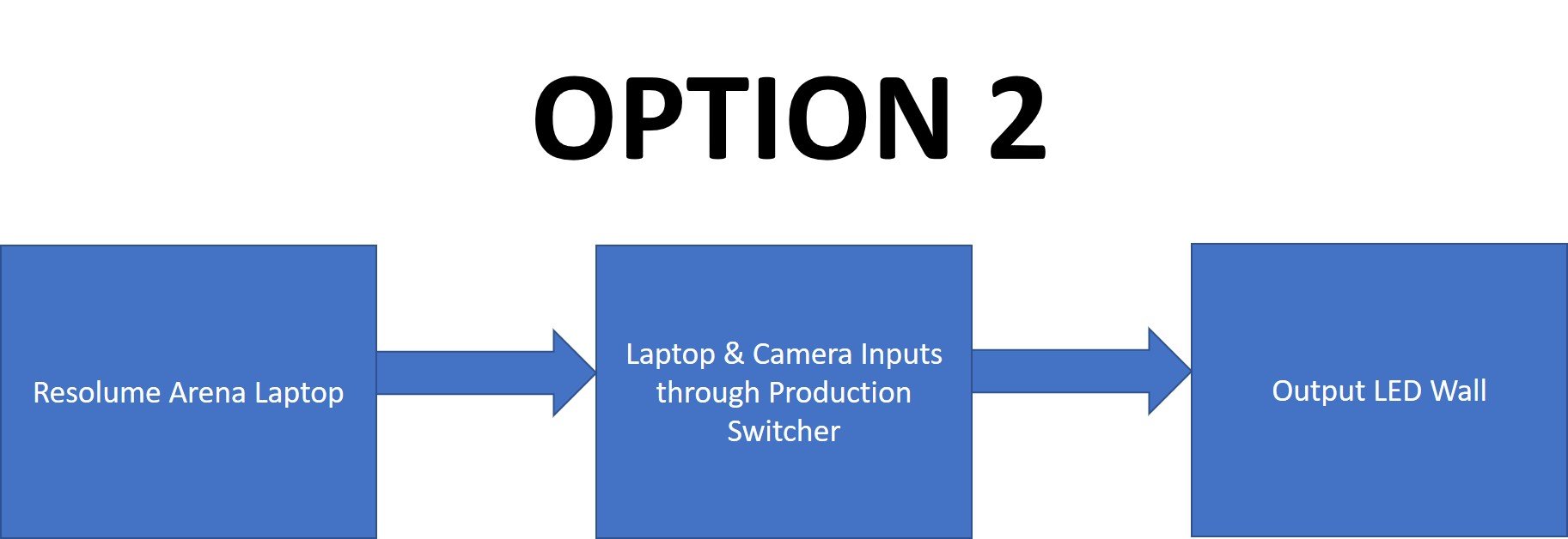

Thanks He2Neg & Oaktown, Just so that i am clear, i have psted 2 pics, option 1 is what i wanted but what you guys are suggesting is option 2 . My query in option 2 is , what if I have a wall in which i have a presentation and graphic and possible a live input feed to be projected. How will i be able to put different inputs in my resolume if it is going through a production switcher ..Image
Guessing this what Oaktown you mean by placing a production swithcer in between
This is my scenario, have a led wall on which have graphics and 1 ppt and 1 live feed.

I’m actually suggesting Options 1 AND 2, all you need is a capture card in your Arena server (BMD Duo 2 or Quad 2 for instance). For instance, the BMD ATEM 1/ME has 1 main + 3 auxillary outputs (which would pair well with a Duo 2) and the 2M/E has 1 main + 6 auxillary outputs (which would pair well with the Quad 2) so you could feed multiple signals into your Arena comp or feed multiple screens from your Arena comp depending on which one is upstream and it’d be easy to flip.
He2neg
Posts: 946
Location: Berlin, Germany
Re: Resolume/Watchout or Resolume/Datapath???????
Post by He2neg »
The Productions switcher not only switches between the different sources.
It can place multiple sources above each other / or side by side / or key something to overlay / etc / etc...
It somepoint it may be smart to get some source inside Arena and use it there and send the final result further.
