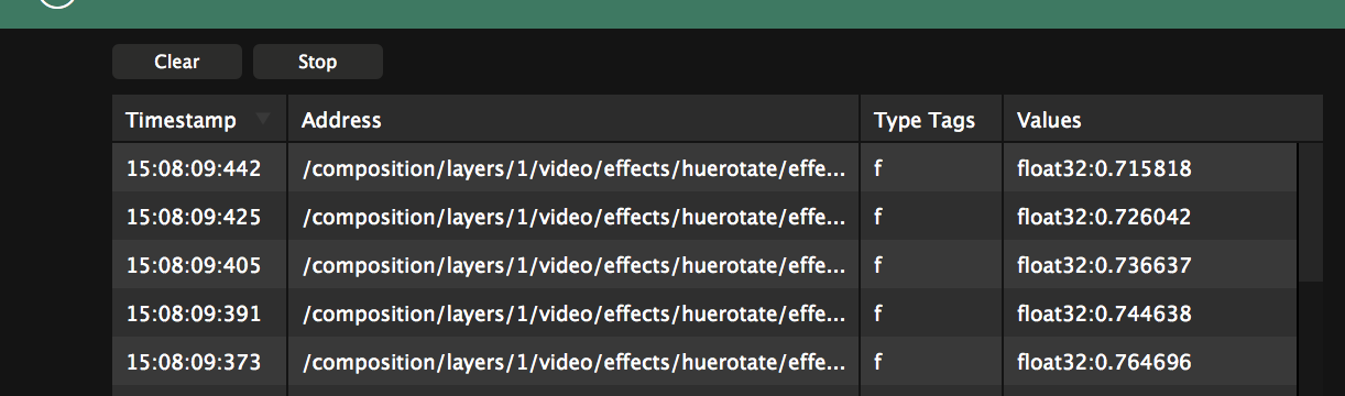

Posts: 7704
Re: hue rotate not working on TouchOSC
works for me too, I just synced up the template you sent to my phone.
Didn't change anything.
