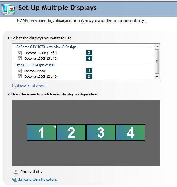

I just added a screenshot of my nvidia control panel on this laptop with the optimus issue.
Is this exactly what i am seeing here , optimus at work , why 2 displays are on the intel , 2 other on the gpu ?
And is that why starting from a secondary (must be on a gpu port) screen seems to fix it or ?
Still trying to get my head around this and if there is anything to do yet about it ..
