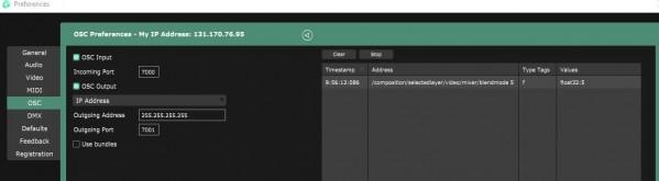

Neither do anything. Prefs/OSC show OSC commands coming through but no worky.
fyi>> Type Tags 'F' and Values 'Float##'
Should that not sho 'i' and 'Int##'?

It shows what it receives. Looks like TouchOSC sends its values as floats (5.0) , not ints (5).
To get this to work, there would need to be a setting in TouchOSC that explicitly forces it to send the value as an int.

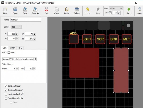

Thanks. I assumed as much, but cannot find anything. Even if I use: /composition/selectedlayer/video/mixer/blendmode "Alpha" it no worky :(
Though the odd thing is that to trigger a clip (with int value) the same button works fine!
note: In pic below it shows I have added /int to string, that was me experimenting post issue at hand..
Adjustable parameters for push button

You'll need to contact TouchOSC support on how to send an int from their software :/

eg Resolume output
eg Resolume output

Yes, I understand that. You're still sending a float message.
The type of the OSC message (float or int) is decided by the program that sends the OSC.
We don't make TouchOSC. The developer of TouchOSC can tell you how you can send an int from TouchOSC.
