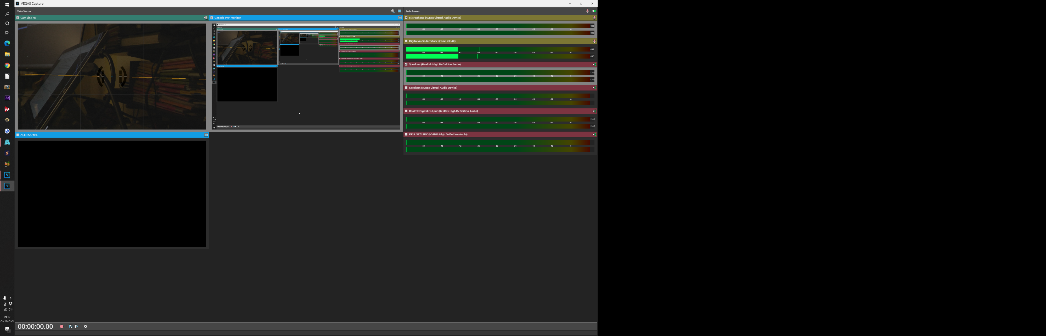

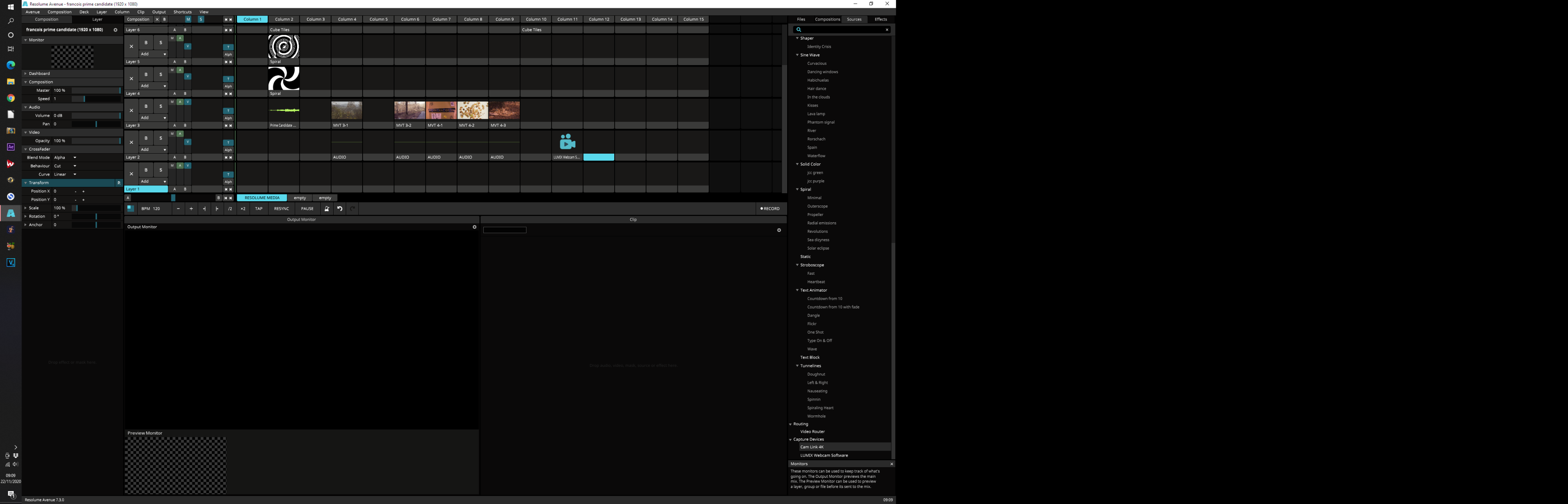

I'm not quite sure what you're after, but attached are two screen prints:
1. Resolume screen showing Cam Link 4K and Lumix Webcam Software listed as Sources. Now that I've loaded the Panasonic software, the Lumix software is always visible, whether or not I have a camera attached. (as a side comment, this is actually quite handy when I'm laying out columns/layers for a performance.
The Cam Link option only appears when I connect the Cam Link (and camera) - which is the case in this screen print. The issue is that I can click and try dragging the Cam Link 4K Source to an empty column/layer, but nothing appears in that slot.
2. Vegas Capture screen to prove that the hardware etc. is OK - i.e. you can see an image (from my camera, via Cam Link) under video sources.
