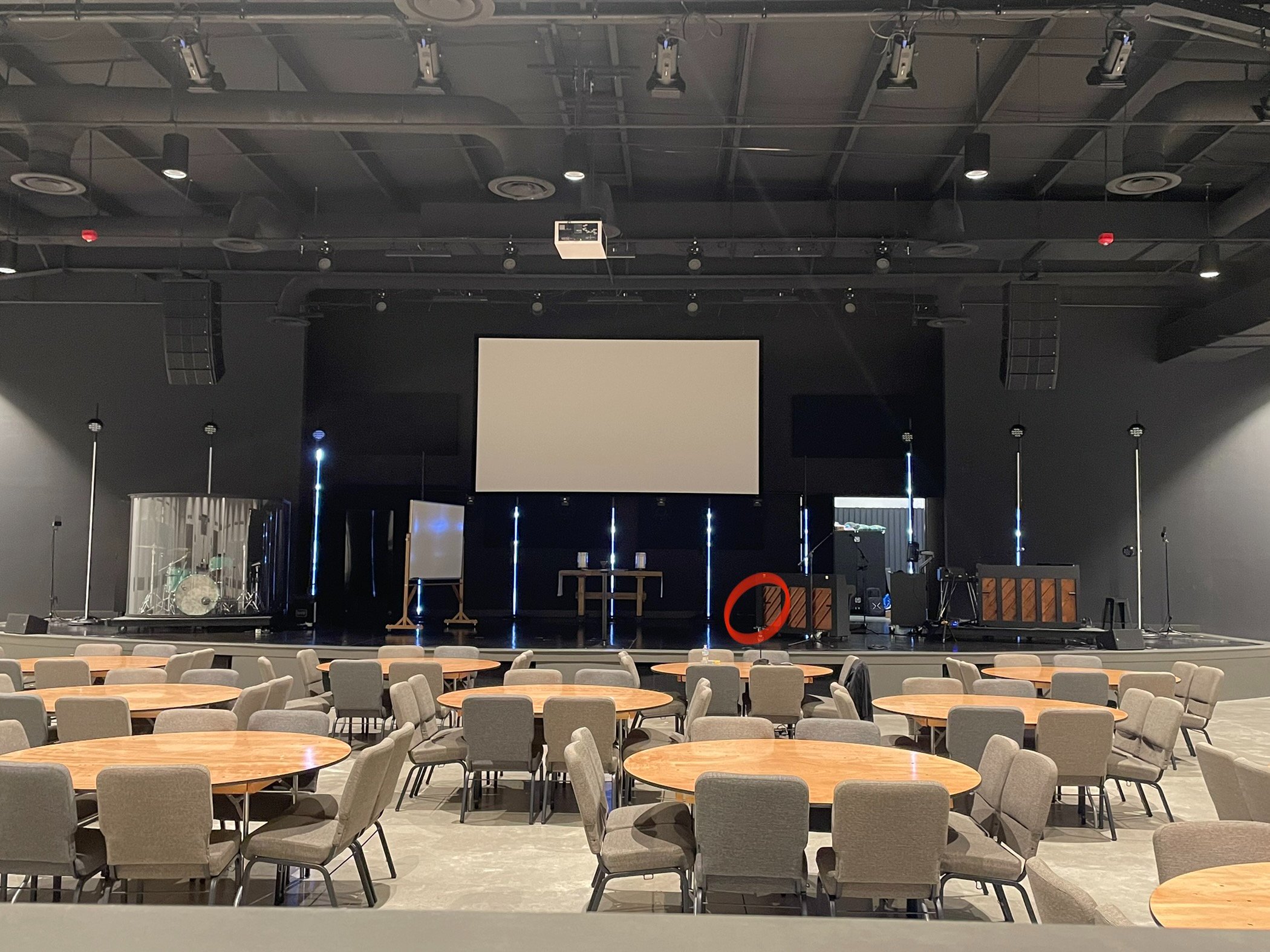

The 10.10.12.etc is a carryover from when our subnet when our art-net network was on the main building network since our switch got delayed when we first moved to artnet for control from our MA3 wing.
I actually have been working at it with the advice you gave and got the first 3 universes on each port working. but for some reason when the 4th universe on each port starts I can't get those to patch properly. Still playing around with it tho.

Update! Everythings is up and running, it was just an issue with the drive not actually saving some of the IP configs changed I made for the 4th universe on each port lol. I really wish they would put the IP fields in the web portal so that I wouldn't have to make so many runs to the rack lol.
Thank you so much for all your help!!! I promise in a few weeks I'll be on the 2.0.0.xxx train with every other normal person lol
