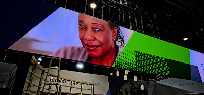

Its not any refresh issue or any thing, its happened when i updated my graphics card from 2080 to 4070ti.
I have same issue when using the 30 and 40 series cards. So many times i hade this issue till now and im always switching the resolume to othe softwares like kommander. Recently i updated new driver and new 7.15
Not everytime when i play only graphics there is no flickering, but when i use it in conferences i put the exact led pixel background video of the event (dxv3 converted)
Or using a png of same pixel size it starts flickering.
In the above video I attached in the chat its a small wall below 1920x1080 led also flickering. Client are really bad with this and i cant use this in any conference event.
Please give a solution, i did my maximum to solving this
Gfx card of 40 or 30 series peoples have this issue please report this

Posted: Tue Jan 14, 2025 11:13
by tv_magic
Putting my hand up to say I’ve also experienced this issue. Those patterns in the image of the previous forum post is exactly what we see.
