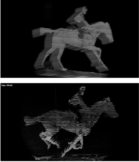

Rutt Etra
Rutt Etra
Rutt Etra.jpg (37.88 KiB) Viewed 18924 times
Top is FFGL Volume bottom is VideoHeight shader running in ShaderLoader
