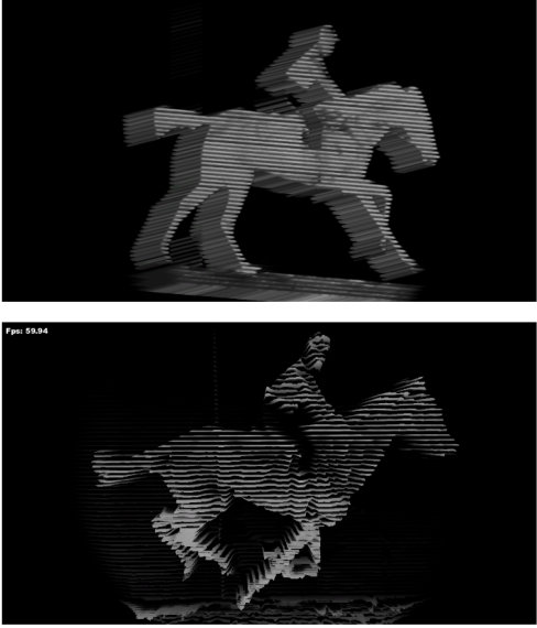

If you're on Windows Top is FFGL Volume bottom is VideoHeight shader running in ShaderLoader

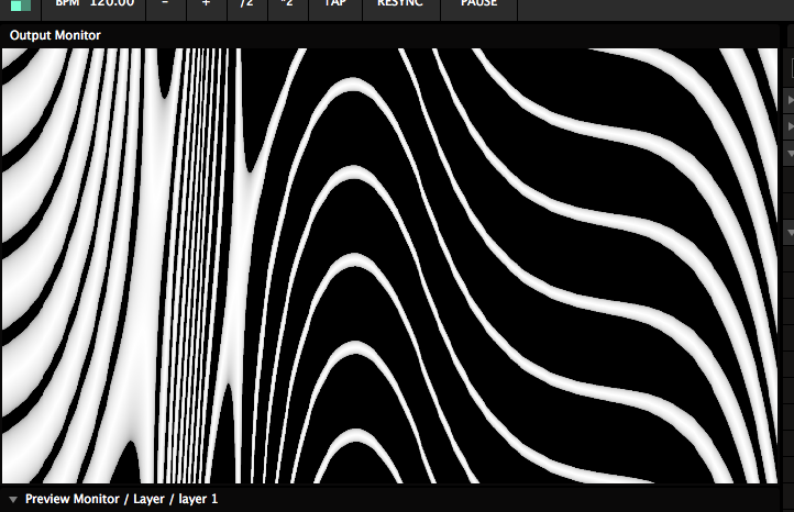

Slit scanning is just basically a feedback technique. Crop your source image down to 1 pixel width, leave it at full height. Then place a Feedback source in the layer above it at full opacity and put its X Position at +1.

Re: Can anybody make a Slit-scanning & a Rutt Etra FFGL plug
When I was referencing slit-scanning I was talking about a different style of slit-scanning found in this Quartz Composer plugin: http://www.memo.tv/archive/timestretchi ... z_composer You can see an example of what plugin looks like in this video: https://www.youtube.com/watch?v=YtM6b7AyKLc Is there anyway to to do this style of slit-scanning in Resolume without Quartz Composer?
