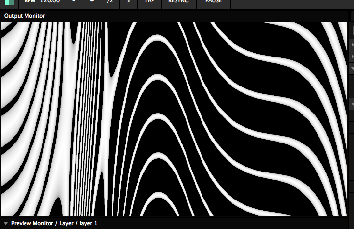

Slit scanning is just basically a feedback technique. Crop your source image down to 1 pixel width, leave it at full height. Then place a Feedback source in the layer above it at full opacity and put its X Position at +1.
Welcome to 2015 :)
SlitScan.avc
(29.54 KiB) Downloaded 1338 times
