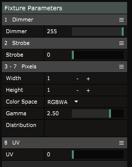

+1 on this.
Of course driving the UV channel from resolume doesn't make much sense. But being able to create such fixtures would be nice. It would be possible if additional parameters could also be pixels and not only simple values.
Like this:
then another 1x1 pixel and 1x parameter and so on.
Greetings
Fabian
