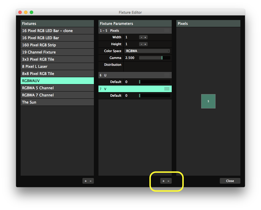

Just add two dummy channels to your fixtures and you should be set.
Re: additional DMX-Channels in Fixture-Editor...
You can add as many extra channels to your fixture as you like.

You are right but every bar has 12 lenses! Your example just shows the first "lens"... That would just work for a PAR which works as one big bulb. Or I would need to set up 12 *10 bars = 120 fixture, altough I have just 10 bars with 12 pixels...
If I rise the witdh to 12, all rgbwa-fixtures are added to this pixel-block before your shown u and v -channels. (btw: uv means ultraviolett and is one channel)
So to understand: Try to build a fixture like this:
1-red
2-green
3-blue
4-white
5-amber
6-UV
7-red
8-green
9-blue
10-white
11-amber
12-UV
... (12 times per bar)
Your example would work, if I was able to add further pixel-blocks to that fixture after adding the UV-channel...

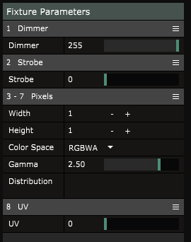

Of course driving the UV channel from resolume doesn't make much sense. But being able to create such fixtures would be nice. It would be possible if additional parameters could also be pixels and not only simple values.
Like this:
then another 1x1 pixel and 1x parameter and so on.
