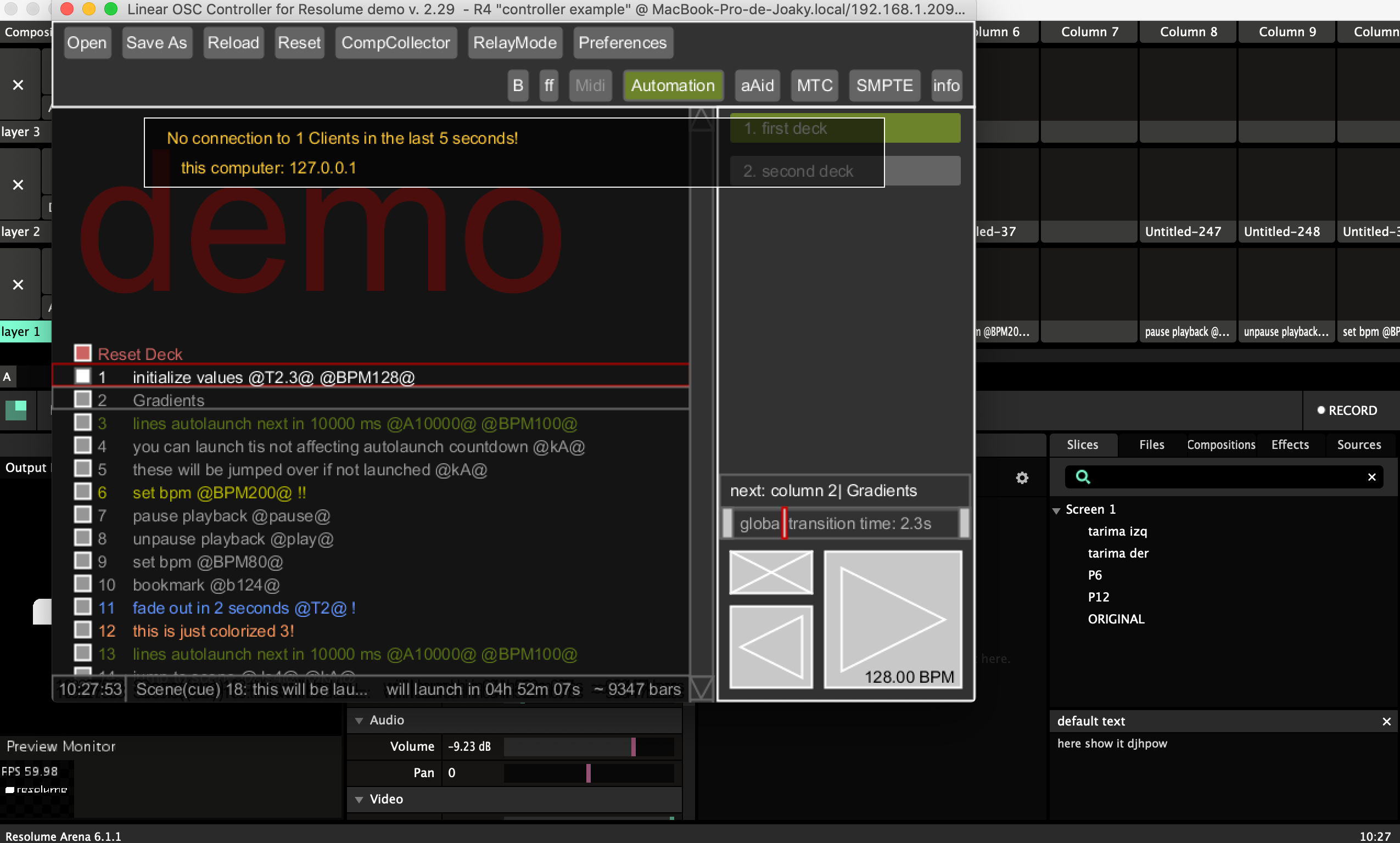

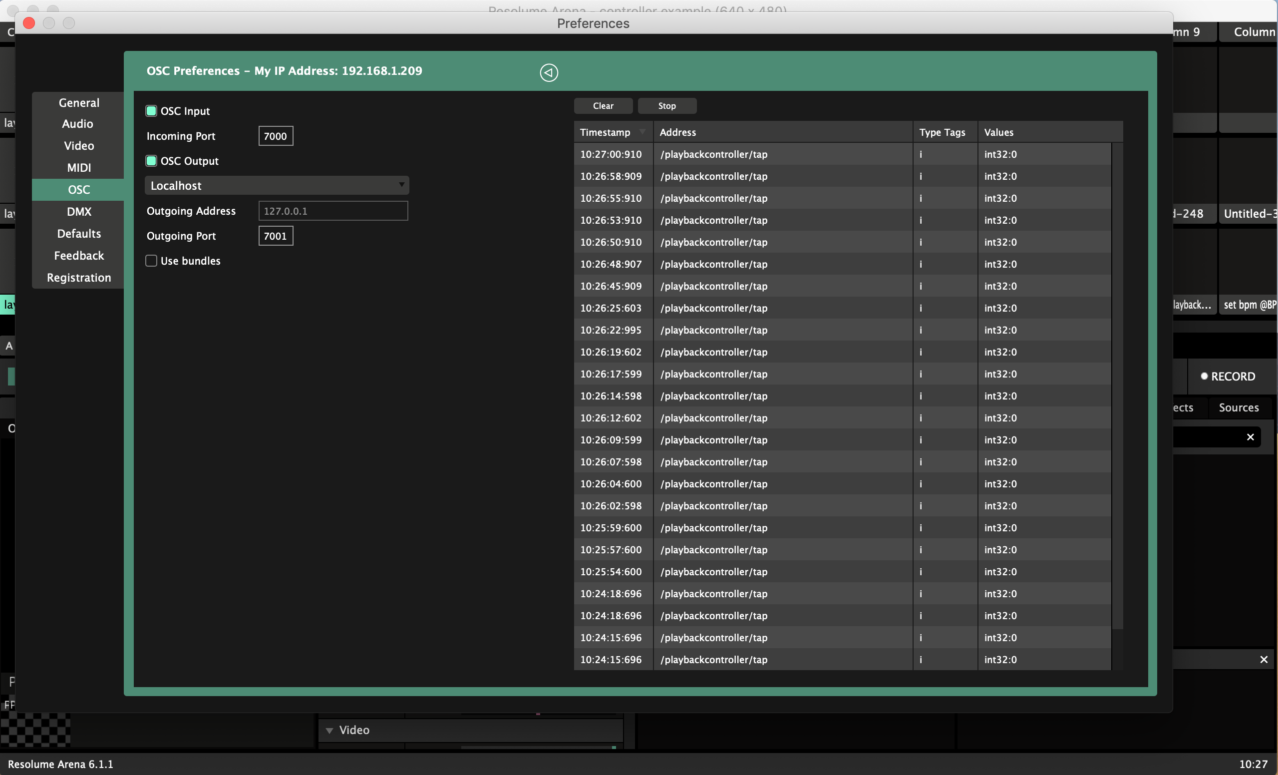

Hello, I'm interested in using the Zoltan´s. I have tried several computers, with windows and mac, but I am not able to connect it. In the OSC window of the Arena I see the messages that enter. Is there a problem with the latest version of Arena? What I can be doing wrong? Thanks

Make sure OSC input and output are turned on in Arena and that you've got matching ports in Controller (Arena's default ports are Incoming:7000 & Outgoing: 7001)

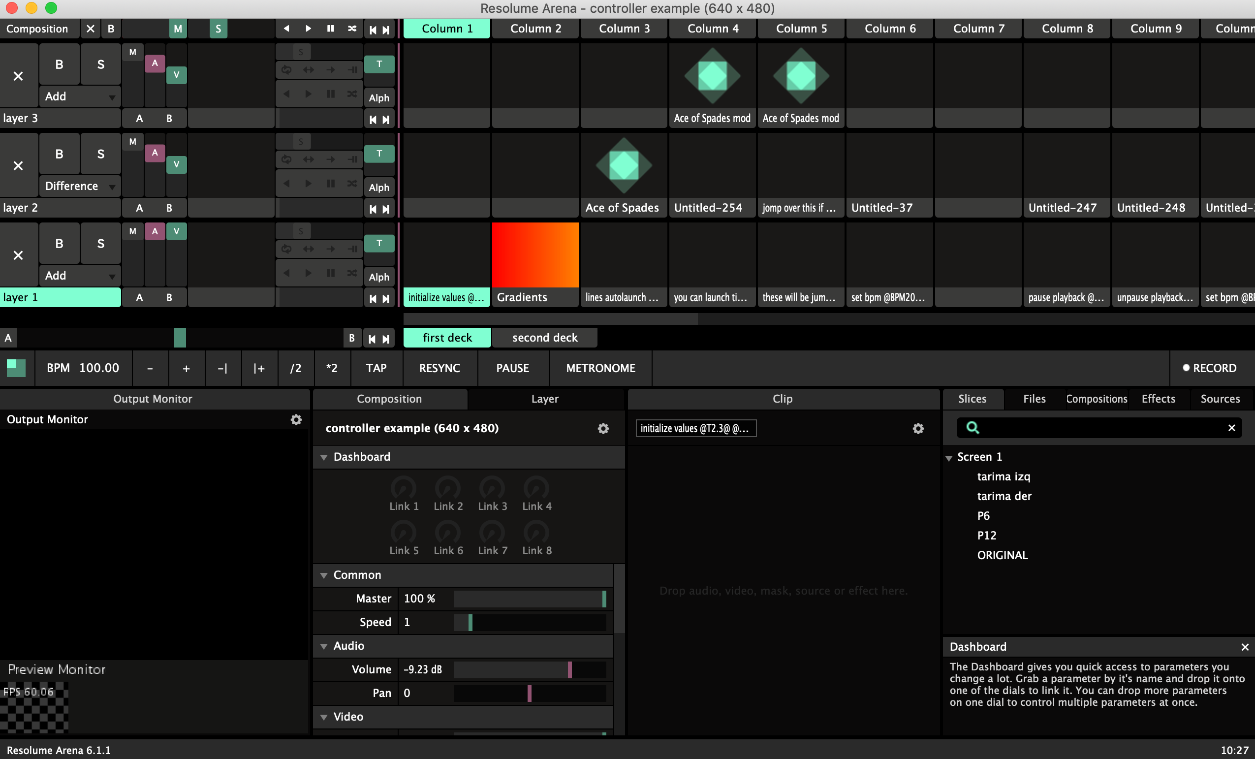

Sound like you are using Resolume 6.
Do you have a composition from Resolume 6 loaded in Controller?

Yes, I use Arena 6.1.1 and yes, I have the composition loaded. I also have activated the osc in / out

Looks like you have a Resolume 4 composition loaded in Controller. (You can see the R4 text in the Controller title bar).
Doing so, Controller will assume you are trying to control Resolume 4.
As Resolume 4/5 OSC message format is different than in Resolume 6, this won't work naturally.
Try loading a composition in Controller, you created with Resolume 6.

Yes!, that was the problem. Maybe you would have to put the test composition is for arena 4/5, and add one for arena 6. Thank you.
