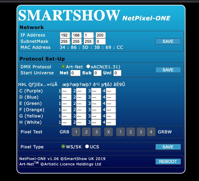

I am trying to use a pixel controller with 32 universes (SmartShow-NetOne) but Resolume Arena only seems to allow me to select up to 16. (0-15)
The controllers I’m trying to use are: http://smartshow.lighting/netpixel-one/
It may be a stupid question to some hardened pro but I can't get my head around it.

There's only 16 universes per subnet, so just jump to subnet 2 to span the rest

Arvol wrote: Wed Jun 01, 2022 18:03 There's only 16 universes per subnet, so just jump to subnet 2 to span the rest
Yes. Nailed it. I can now control all 32 universes per controller.

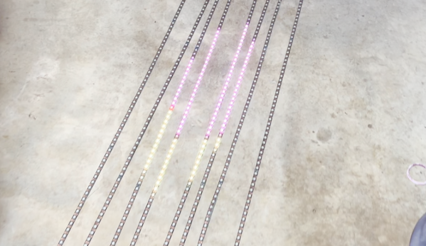

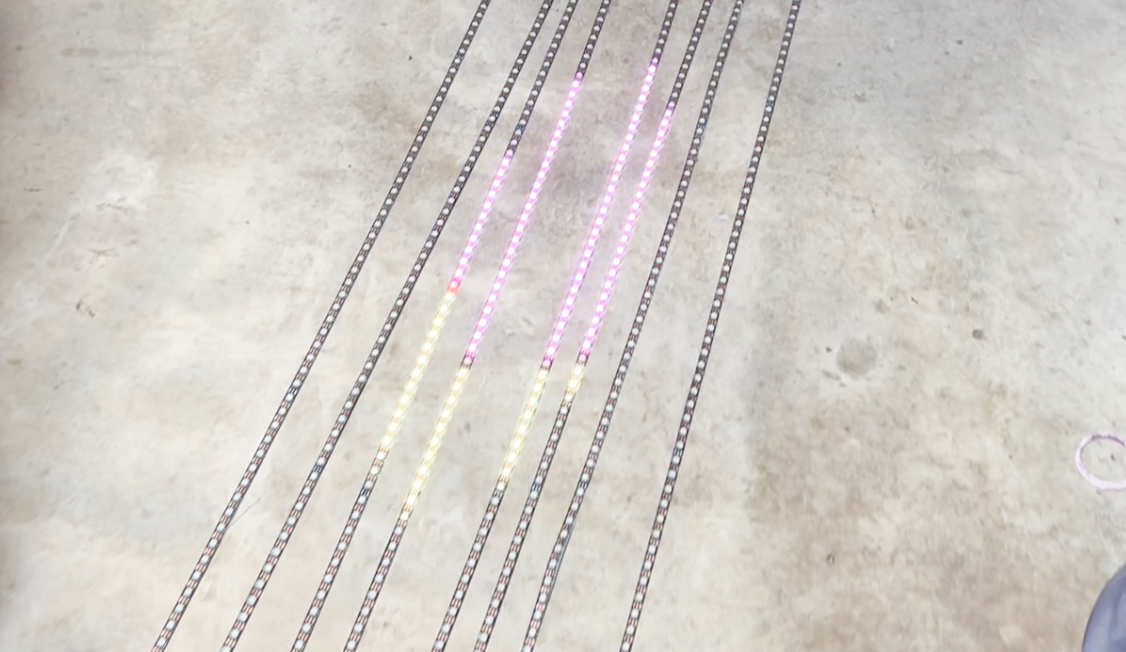

Now I've got this spare pixel flickering at the end of each universe and it changes the colour of the following universe.
This has only started happening after the latest update?
It has messed up my other 16 universe panel and controller set up as well.
Posts: 7705
Re: 32 universes controller mapping
There is the "Align output" option for the Universe auto spanning, check your controller how it addresses the pixels. With Align on, the next pixel will start in the next Universe.
I think you need to set it to Off, based on your picture.
