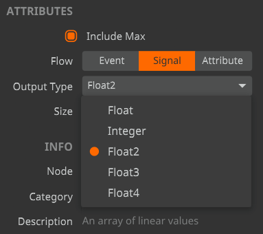

In the meantime I noticed it seems to only break if you feed a single float into the translation-inlet (which expects a float2 but can automatically convert a single float to a float2). Little tip - you can also set the linear-node to output float2, then you have individual control over the range on both axis:
Screenshot 2023-12-20 170212.png (28.51 KiB) Viewed 13034 times

Christoph wrote: Wed Dec 20, 2023 17:03 Yes the transform-node not switching back to shape-mode is not expected behaviour, thanks for reporting that. This should be fixed in one of the next updates.
