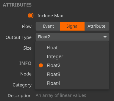

In the meantime I noticed it seems to only break if you feed a single float into the translation-inlet (which expects a float2 but can automatically convert a single float to a float2). Little tip - you can also set the linear-node to output float2, then you have individual control over the range on both axis:
Screenshot 2023-12-20 170212.png (28.51 KiB) Viewed 13029 times
