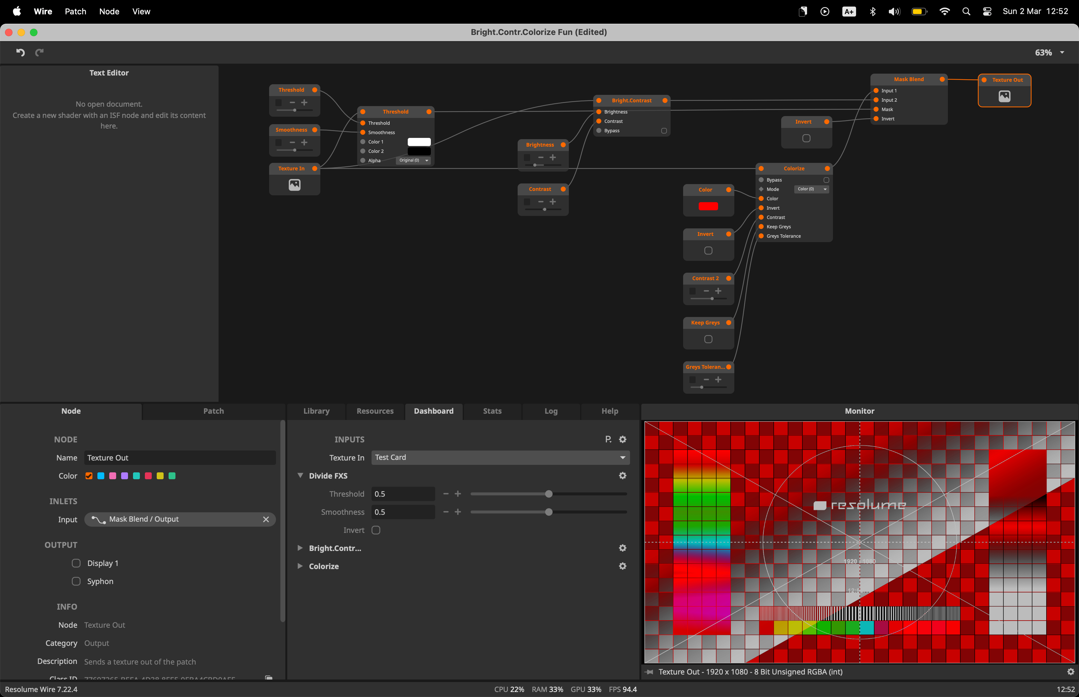

I'm not sure if that would give you much boost. Here is a plug-in for you to try. I just put the brightness contrast and colorize after each other so you could test.
Bright.Contr.Colorize.wired
(10.94 KiB) Downloaded 240 times
I think it's mostly easy if you combine effects, that you can make presets for all those effects together and easily switch presets for multiple things at the same time. But I'm not sure if it would give you much speed increase. And Wire is of course nice to make your own versions of the effects, do stuff with automation or combining things together in new and exciting ways. Like taking the two effects on top and combining it with a threshold will give you some interesting effects. Where one side off a threshold will get colonized and the other side will get brightness and contrast then stuff gets fun. Check it out.
Bright.Contr.Colorize Fun.wired
(11.56 KiB) Downloaded 233 times

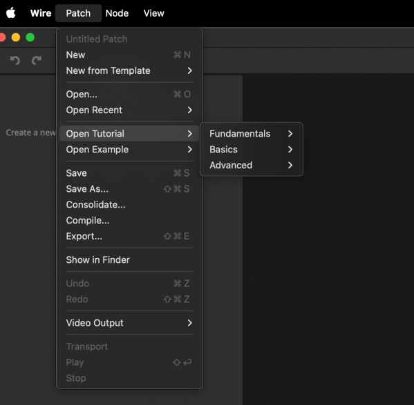

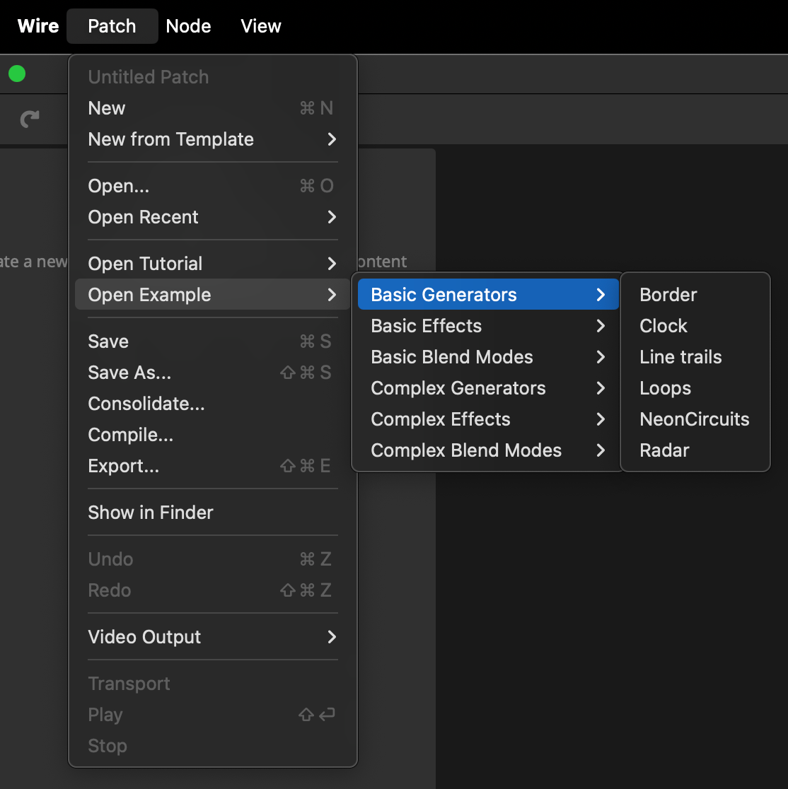

tijnisfijn
Posts: 355
Re: Performance with combined effects layers vs individual
Post by tijnisfijn »
This is definitely something that wire will shine in and can do some nice stuff. I think the best place to start would be the Resolume YouTube page https://www.youtube.com/watch?v=Aq3PEoa ... M1y_dlBf0Q and Wire itself. There are loads of tutorials and examples inside of Wire and every node has his own documentation as well. You can just open those patches and play around with them to start with.. And if you have any questions, don't hesitate to ask it here or on our Slack Channel : https://join.slack.com/t/resolumecommun ... N5T414CDaA
