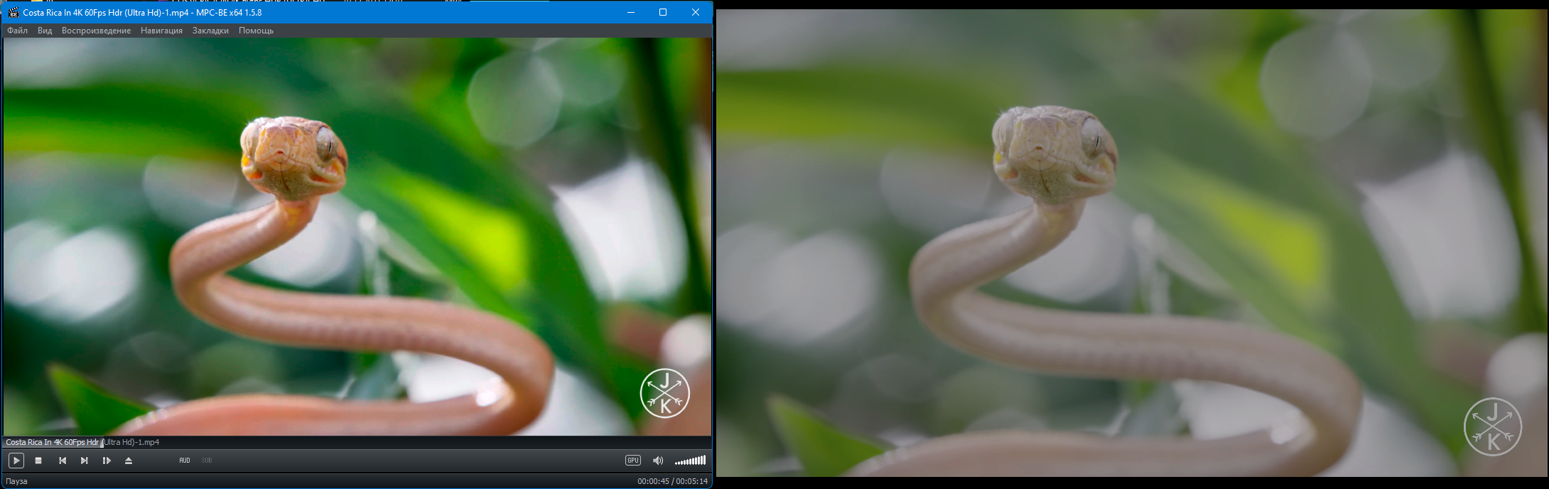

Post by elgarf »
Is there way to convert hdr video with alley?
On the left - how MPC play this video, on the right - Alley.

hdr is actually quite interesting for some effects even if the display cant show it. For example if you have two white lines overlapping, then a bloom effect could show the overlap to be extra bright (wider blur) when compared to the lines themselves.
The Resolume graphics pipeline does not support hdr so alley doesn't either. Out of curiosity, what kind of file format / codec are you using?

I downloaded this from youtube.
https://youtu.be/LXb3EKWsInQ
Though my display can't reproduce HDR video, MPC uses LUT to convert it from HDR to Rec.709 colorspace (I think), so I see bright colors even on non-hdr display.

Resolume does support 16bpc processing, which is not exactly HDR per se, but has the scope for processing HDR-like content.
I am actually very interested in using high bit-depth content for effects that would be like live colour grading. I've often been disappointed by trying to use things like Chromakey ,or when pumping brightness and contrast really shows up various artefacts and limitations of 8bpc source material.
