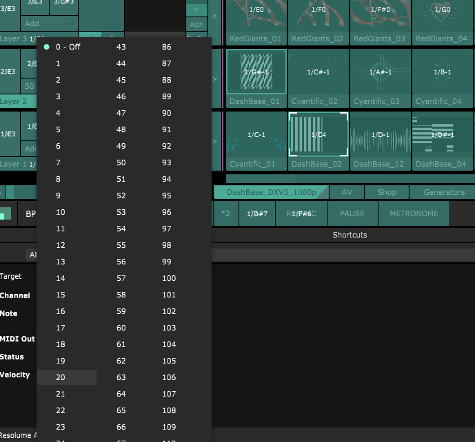

Cannot add color on Midi Mapping, i'm missing something? APC MK2
Re: Maybe a bug with the Persistent feature
You have APC40MKII selected for input and output in the preferences options?
It goes off what device is triggering the shortcut.
ie. my MIDI fighter will show what you are currently seeing when I press a button, but when I press a button on my APC40MKII it will show up with colors. (i'm on a pc)

dinga wrote:You have APC40MKII selected for input and output in the preferences options?
> Yes i have, when i select APC 40 MKII on presets the controller lights go up, but I can't change any color.
1. Already existing mapping show the table color, but when i try to change, controller button light goes off
2. New Notes appear the table in the image above
Also when i close and open again, Resolume doesn't set the right mode on Preferences Menu, nor Shortcut Midi (always default).
