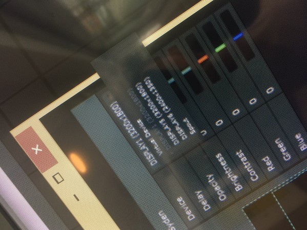

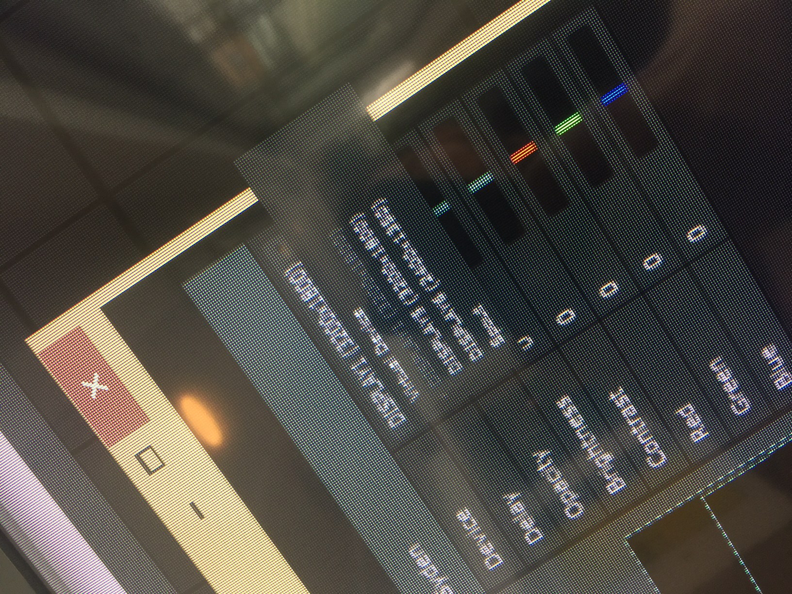

Hi, gang!
I have a problem - screen resolution and monitor sync with WIndows, Arena,
Spec:
Windows 8, Arena 5.1, 2x Nvidia GTX 980 and 2x Datapath X4 on DVI DL outputs.
Local monitor on HDMI from one of the 980s.
PC won¨t deliver more than 2560x1440 to the X4s.
X4s could of course receive 3840x2160 form the PC, but the PC doesn´t give that as an option.
Arena sees only weird outputs (3200x1800, 2400x1350...)
Additional problem: One of the beamers doesn´t accept 1080@60 (59.995), only 1080@30 (29.xx).
I´ve found this tool, but I´m not sure if that´s the solution:
http://www.monitortests.com/forum/Threa ... tility-CRU
Any ideas?
