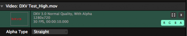

Do you have an alpha channel in your clip (RGBA)?

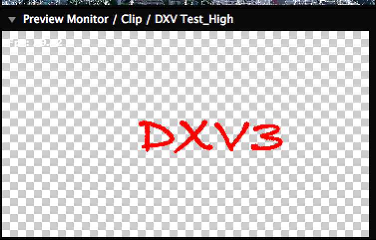

When you preview your clip, do you see the alpha grid in the preview window?

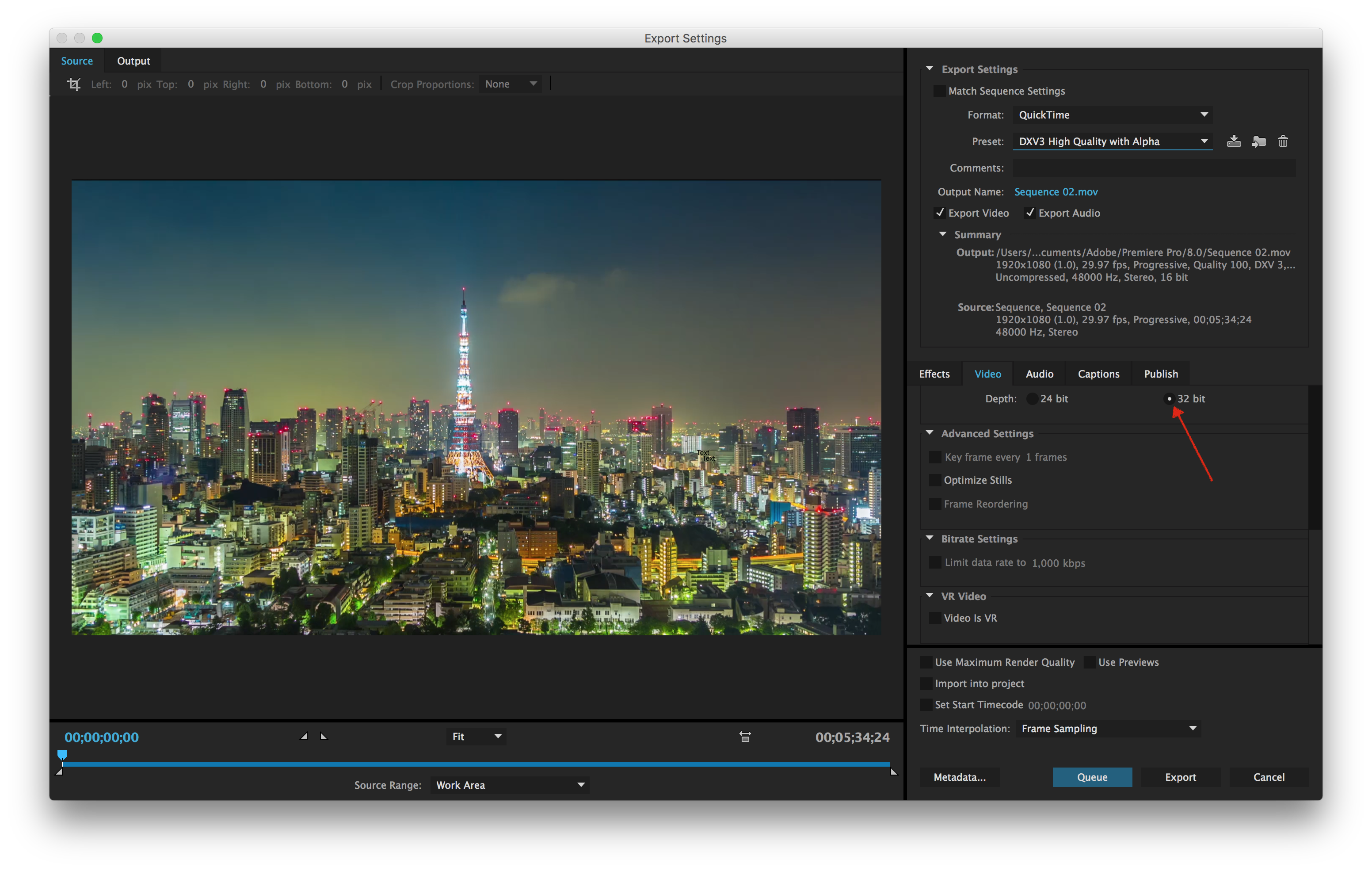

In Premiere, make sure you're using the max rendering depth (32-bit) in the video settings when you render DXV with alpha or the alpha channel won't be preserved during the encoding process.
