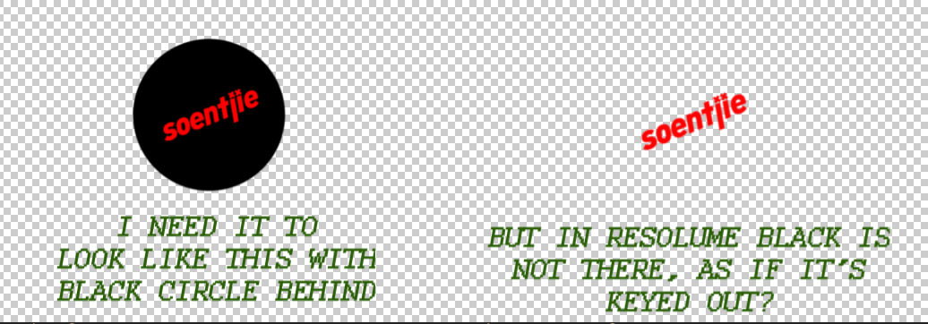

I rendered a bunch graphics from After Effects, the color black is part of the design and need to show but in Resolume it looks like the black is also keyed out or unmalted.For example I have a logo on a black circle the logo will be the top layer on a red background (bottom layer). THe black doesn't show up
I rendered out as DXV codec with alpha, when I bring it back in AE there is definitely an alpha so that is not the issue, resolume also confirmed that the video clip has an alpha.

Try setting the layer's blend mode to alpha and 100% opacity.

Re: Color Black not showing in graphics rendered with Alpha
Probably a straight vs pre-multiplied issue!
Resolume defaults to pre-multiplied. You need to understand the difference between straight and pre-multiplied so take a look at this post (and thread) to understand matting better.
Also, make sure you render your alpha files in maximum depth in 24+8 bit (8-bpc + alpha).
If you're having issues with the alpha channel with DXV3, you might want to take a look at this older thread.
You can't project a black image because black is the absence of light.
So, are you talking about using a mask for other content?
Take your L1C6 clip, move it to L2C6 and add a color clip below it for you to see the black outline.

Hy,
Did you create a black solid on After effect or did you just applied a mask on a background?
It' not because it's black in after effect that means it will be black rendered, specially if you go with alpha channel.
To be sure that black will be rendered as black and not alpha, try to change the setting of your composition in after effect and change the black background with a colored one. Everything who'll have have the same color as the one you choosed as background will be rendered as an alpha channel.
Post by subpixel »
gesp wrote:I have the same problem here.. I already export in "Rgb" "alpha" "rgb+alpha" and in resolume i already try "add" "luma"
Can someone help me?
Set your layer's blend mode to Alpha and opacity to 100%.
Although most blend modes work out the same as "Alpha" when set to 100%, you should consider that it doesn't make sense to "add black" (you are adding zero to the red, green and blue values), and the luma value of black is zero, so using Luma Key blend mode will make it disappear.
