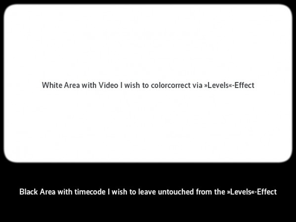

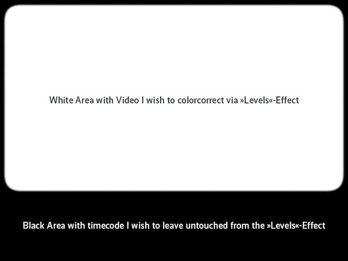

Is it possible to colorcorrect a specific area within a Video and leave the rest untouched?
For Example: I have a video with a timecode running underneath. If I do corrections on this clip using the »Levels«-Effect, the timecode is affected as well.
Using a mask will of course allow me to mask out the area and then put the effect on this, but this causes my timecode to vanish.
Please take a look on the image attached. :-)

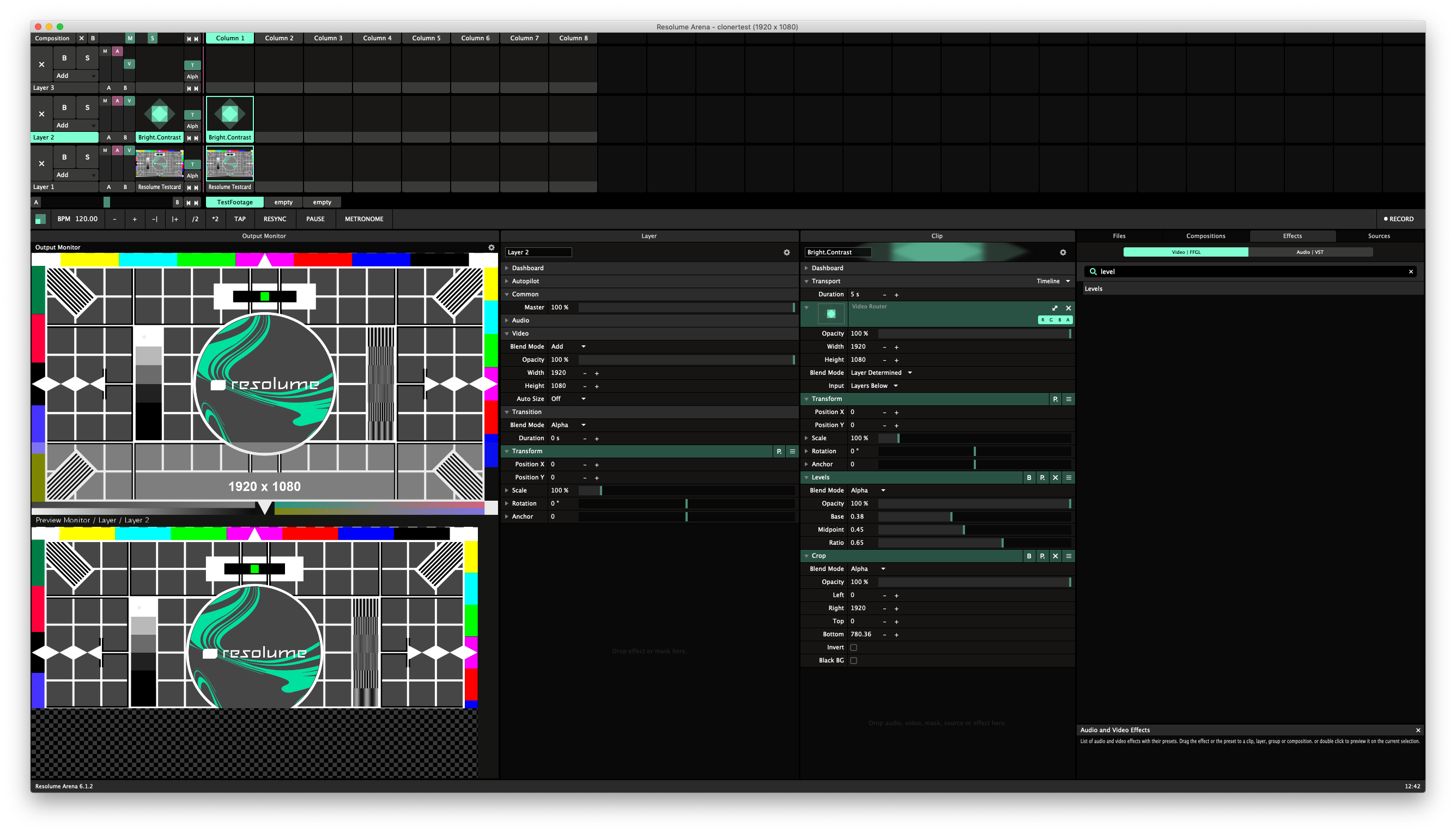

Re: FX only on Masks - Possible?
Use the Levels effect as an effect clip on the top layer, and then apply a Crop effect after it to limit it to a certain region.
klumbich
Posts: 10
Joined: Sat Mar 09, 2019 14:46
Post by klumbich »
Brilliant! Thank you very much!

Joris wrote: Tue Mar 12, 2019 12:42 Use the Levels effect as an effect clip on the top layer, and then apply a Crop effect after it to limit it to a certain region.
Thanks for solving...
