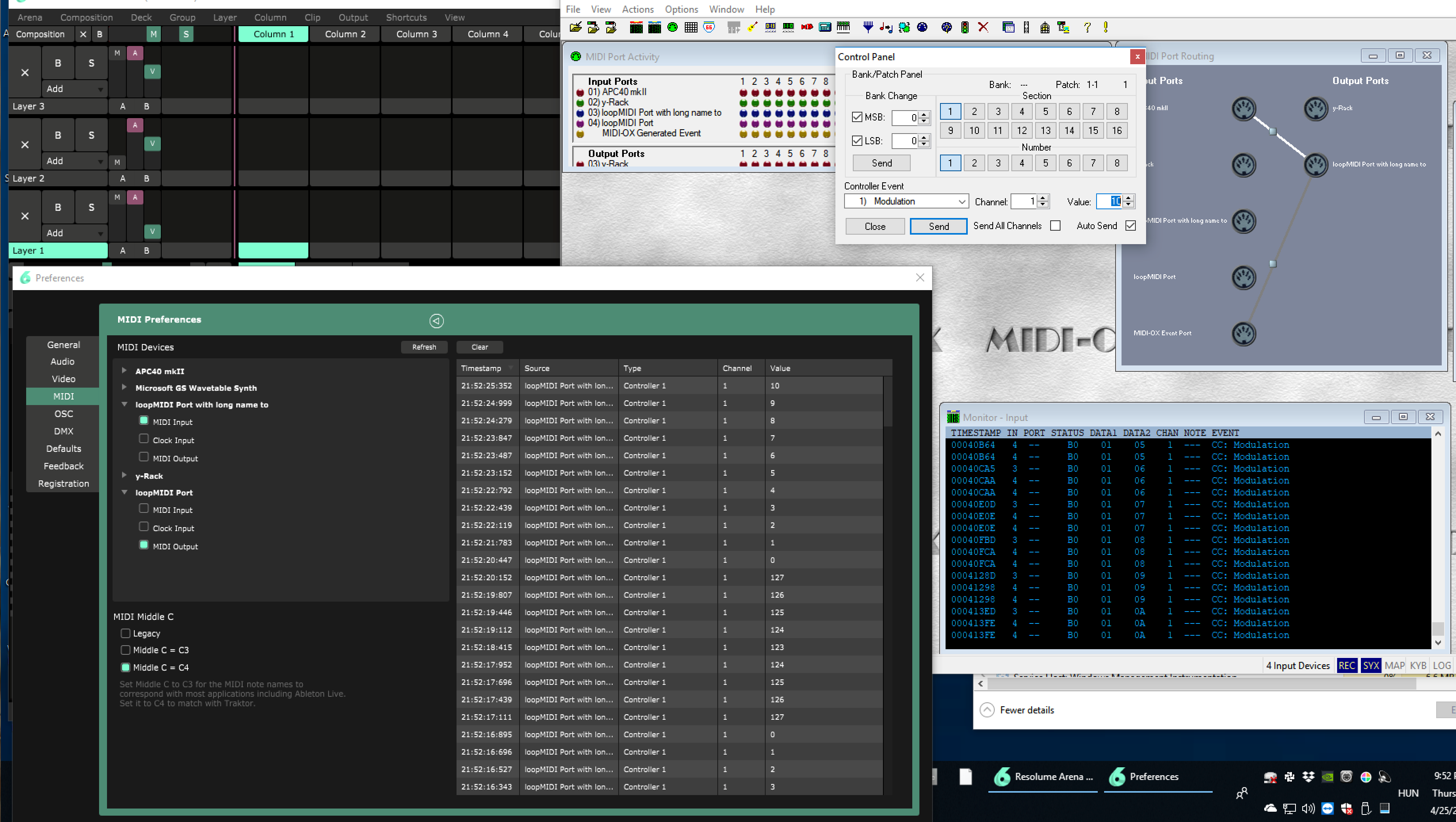

I only get back the same value (twice) I send to Resolume. I use Midi ox event generator to send to Resolume.
This is how I set it up, Device 3 is where I send midi form Midi OX, Resolume outputs to device 4:
Could you send us a screenshot of your Resolume midi preferences, and Midi OX setup where you see different values returning from Resolume?
