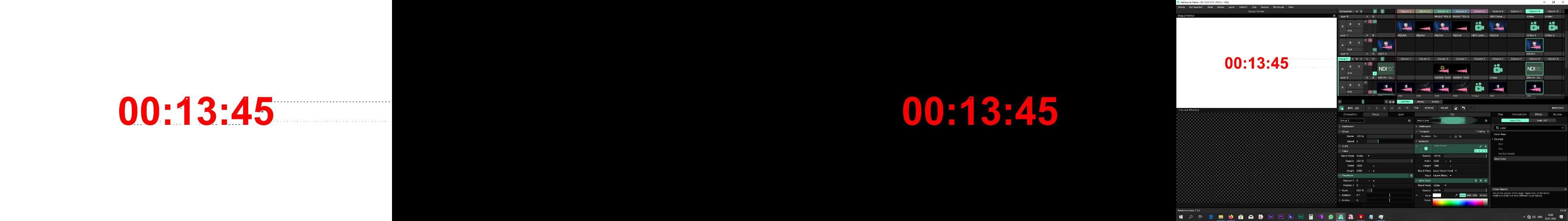

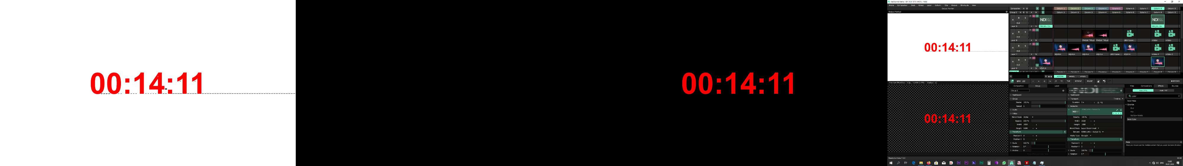

Hello!
I have problem to send NDI alpha from VMIX to Resolume 7. (black lines - artifacts)
In the NDI Studio Monitor and another Vmix everything is clear on alpha)

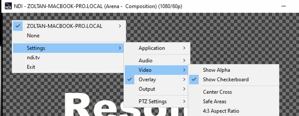

Can you also send some screenshots from Vmix, and NDI monitor with Checkerboard switched on?

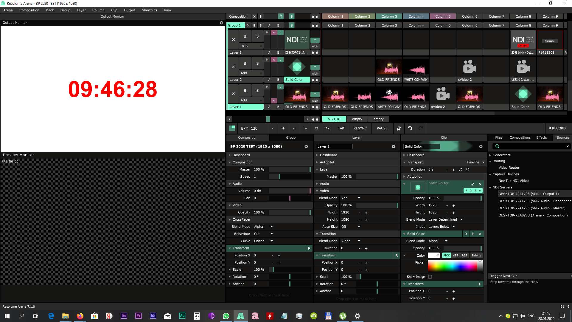

Post by maxislo »
I have tryed on the another set up (and version of Vmix) and everything was fine.

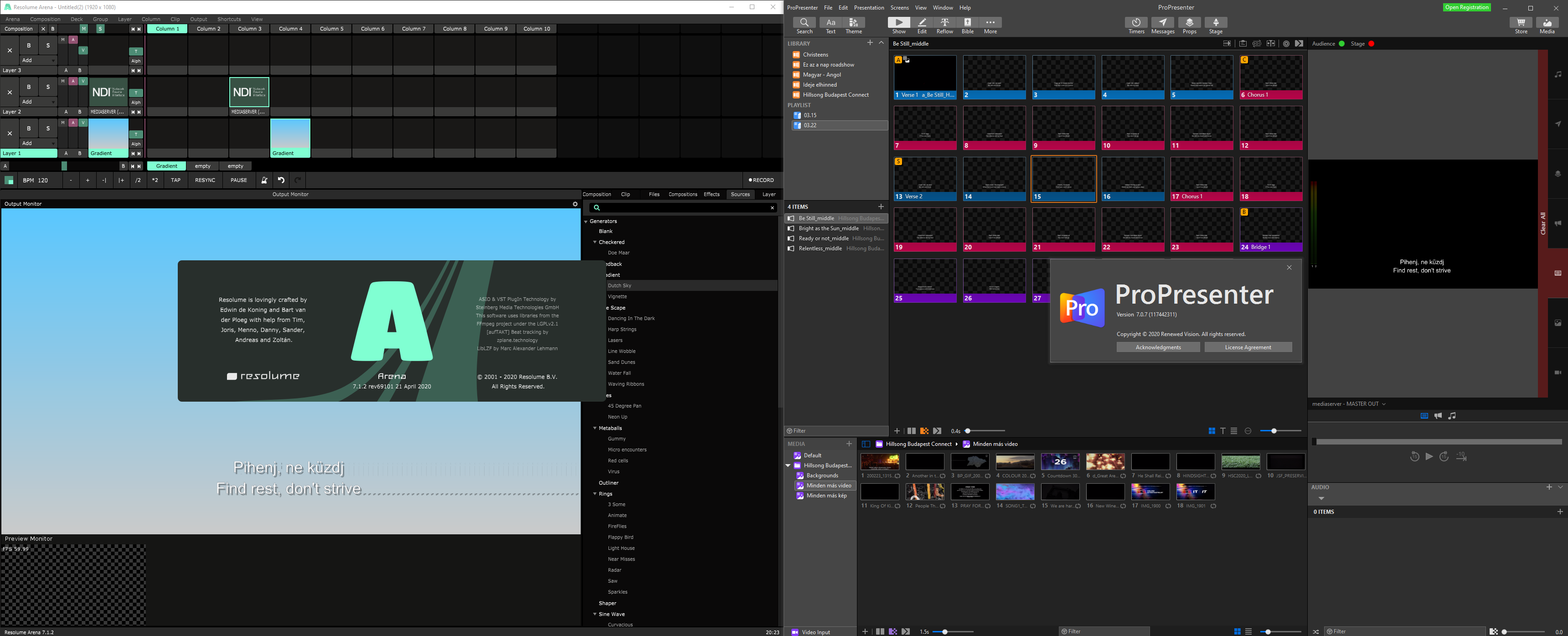

Post by Benceking24 »
I did open a ticket for Propresenter because i thought it is their software's fault but noticed that other has the same problem that i have with propresenter. Artifects next to the element that has contetnt over NDI with alpha channel enabled.
