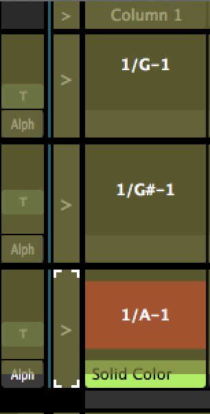

Hi.
I noticed a new button (4.1.9-4.1.10) that i can't find any information about it...
When I'm in midi mapping mode there is a button reveald between the transition time fader to the first clip on each layer and on the column and deck rows that marked ">" (Screenshot attached).
the button is hidden in all other modes.
I tried to map it on a button or a knob but it's not acting like i guessed it will (play next clip/column/deck)...
i can't find it on the manual or 4.1.9-4.1.10 new features.
Any ideas?
what am i missing?
Thanks

Good eye! This is a new 'secret' feature.
It lets you trigger clips in a layer via a single midi cc. You assign the cc to the '>'.
Then each value for that cc will trigger a different clip in that layer. So value 1 will trigger clip 1, value 2 will trigger clip 2, all the way up to 127.
It's basically the same way that DMX can be used to trigger clips with values in a single channel.
